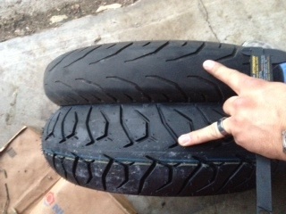

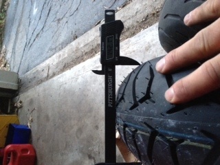

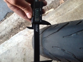

So here you all are. Is there a way to aim the headlight without shimming the mounting holes?
- Reading is 125.9mm
- image.jpg (30.73 KiB) Viewed 9294 times
- Old off the rim
- image.jpg (27.75 KiB) Viewed 9294 times
- Old mounted width
- image.jpg (31.15 KiB) Viewed 9294 times
- New and old with old mounted
142.6mm is the reading - image.jpg (33.75 KiB) Viewed 9294 times
- New and old side by side with new installed on the rim
- image.jpg (31.75 KiB) Viewed 9294 times

I'm not going to lie, after all that talk I did about distorting the tire profile, it really looks as if this tire was made for the PCX's narrow rim. In this case, the only tradeoff would be to added weight of the tires, which is significant enough to slow down accel noticably, as well as top speed on flats and especially up hills. But if you were one who lived somewhere where there were lots of corners that you liked to attack, then maybe this is the mod for you.
Anyway, thx for the pix and for clearing up the debate a bit. That last pic is the money pic. =)
