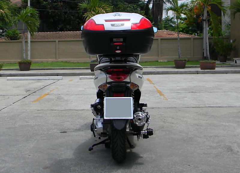

Can you take a pic of the rear tire semi-close up directly from behind? Would like to see how the profile is!

ScooterMan wrote:Can you take a pic of the rear tire semi-close up directly from behind? Would like to see how the profile is!
I have a 140/70/14 on mine. Does this pic help?

I do like the look of a wider tire on the PCX. How does it handle in turns?
