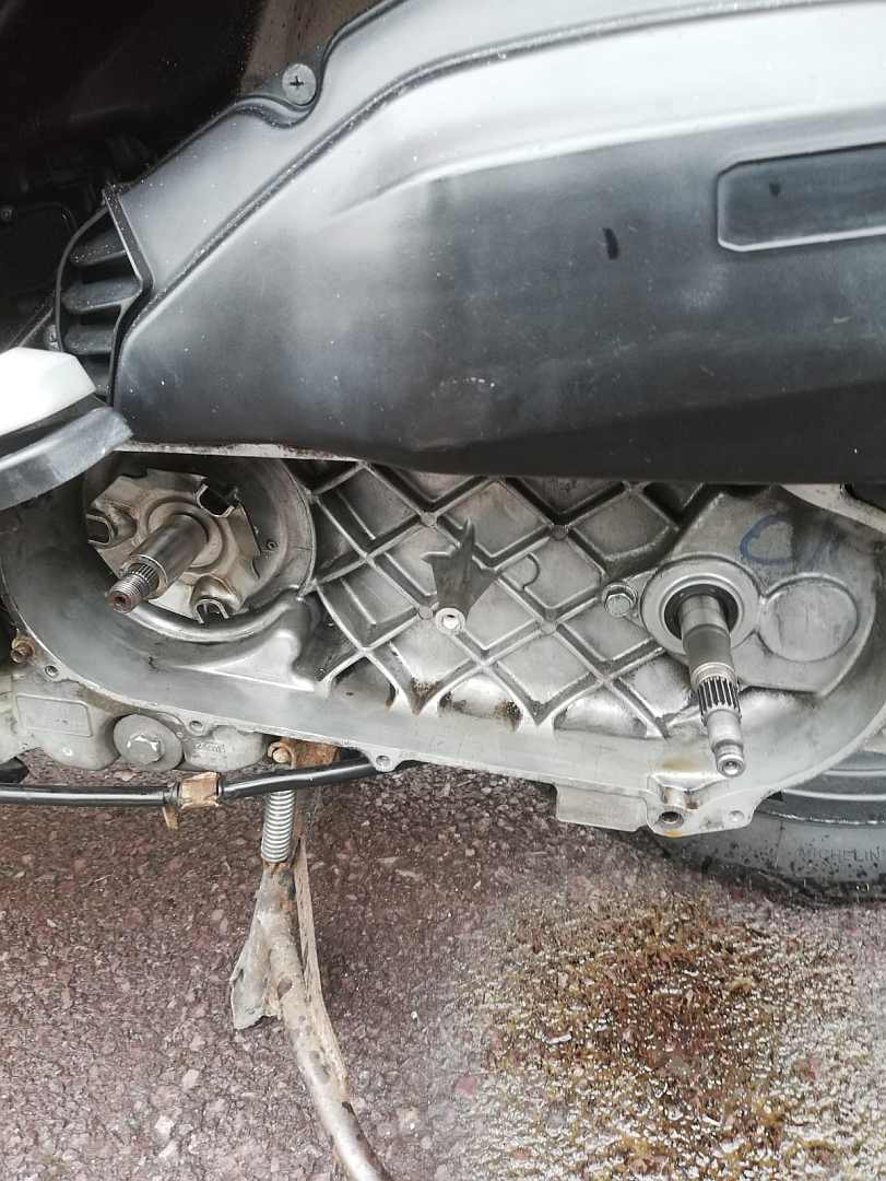

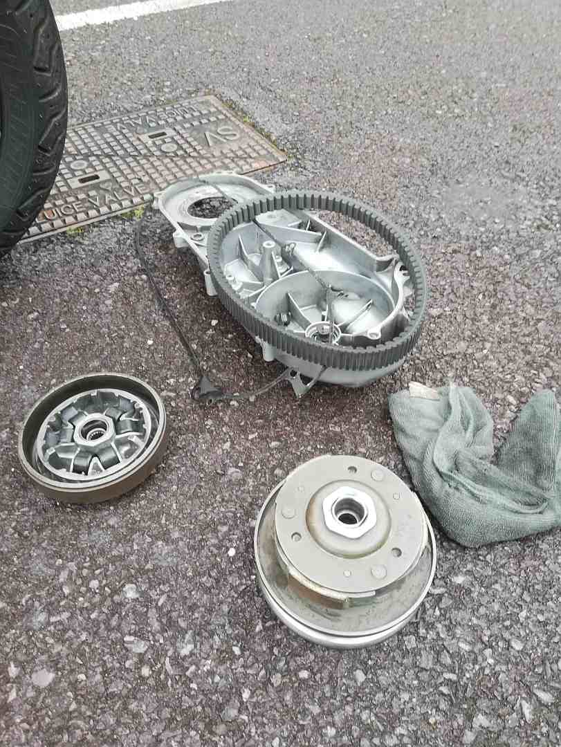

Hi all,
Finally I have an update after long time, sorry for that, I was waiting to get my new impact drill (thanks Lidl) and a 22mm nut socket :)
I've easily removed variator and clutch, nothing was loose or moving, bush pulley has been a pain, stuck and quite rusty on the inside, so after tons of WD40 without joy, I had to use a clamp tool to remove it successfully!?
Rollers weight, sliders and belt are worn out, when clutch and bell seems to be in quite good condition, so I took the opportunity to clean all Cvt case and parts, re grease and reinstall all parts.
Test ride doesn't show any improvement in terms of speed or acceleration, confirming few parts need replacement.

Here a couple of pictures

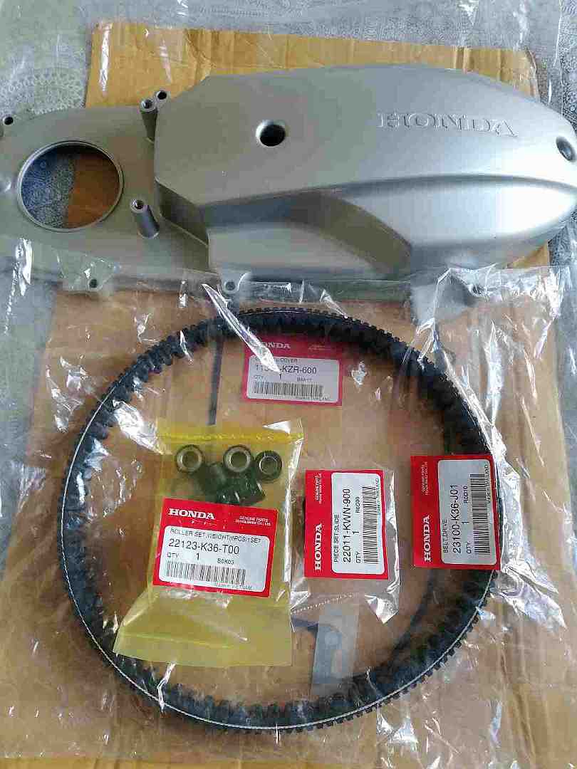

All parts has arrived, ready for servicing in the weekend :)

Just back from a test ride after have changed all parts plus a fresh spark plug, what a difference, now go up to 64-65mph when before were topped at 58! :lol:
Remain a noise coming from the clutch side, most probably one of the face set ball bearing (91009KVY961): turning the tyre in reverse does not show any issue, same without all clutch block.
I also need to figure out how to remove the old CVT cover circlip and bearing before to install the new cover.

TheDoors wrote:I also need to figure out how to remove the old CVT cover circlip and bearing before to install the new cover.
Don't even try to re-use a bearing, the extraction will likely damage it, get a new one.
