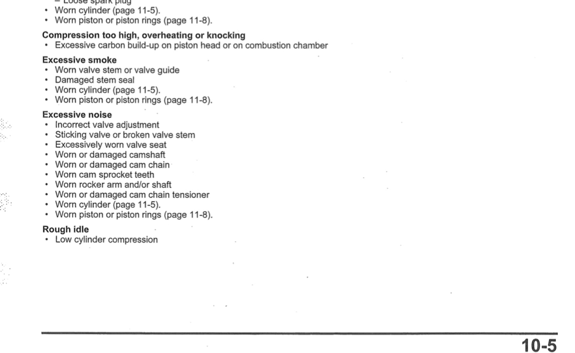

All the right questions, and answers, are Posted right in this chain..
The answer is in the questions..
Many can experience the Same issue..
Have a guy on Stand-by Ready to purchase at 2200 straightforward knowing everything, he’s waiting for me to give up in frustration.. My problem is the “Anxious” disorder inherent with everything i do.. Everything is too Fast in my head at personal level.. wife hates talking to me because I’m done with the current conversation and calculating the next in my head..
Being a research freak as r&d advisory engineer, just have to step back and Look.. What is cause and effect of the questions and answers i posted?
So I goto work for the PCX..
1) added injector cleaner, air filter, at oil change
2) variator acts like a speaker, cleaned out air vent
3) new spark plug is burnt
4) it slowly came on over 1-3 days, 50, 30, then 15mph
Because i do many things at a time with my Anxious problem, coincidental observations have occurred, leading to wrong diagnostics of issue..
What rapidly burns up a plug?
Why does it only make the sound at cruising speeds?
I asked of spark ping, although much deeper tone than that, like a rod knock..
And the Variator acts like a speaker
Combustion knock is the answer
Compression level has exceeded the limits of engine management
Carbon buildup from additives in injector cleaner..
I will be pulling the old plug I put back in, and borescope the piston..
Already know the answer I will see, I will seafoam spray the intake while revving to keep running, then dump heavy to stall it out, let it soak for a few hours to clean the trash out..
See page 10-5
Excessive carbon buildup
See page 10-5

This thing is Clean inside.. and the even keel (over 15mph) rattle persists..
So Lapeer Honda finally calls me back, quick briefing..
His response “well I’ve never heard this one before”
I also state it sounds and acts, like a spark knock, as also specified in manual 10-5, he hesitantly agreed it sounds that way, then proceeded to tell me “it’s not that” to my questions..
I told him I don’t think it’s cam chain tensioner, wrong sound it’ll be clicky he says with a tang slap of chain..
So I ask him, since i am halfway to checking valves, think I should go ahead and set those anyway? He says no it’s not the valves because you’d hear those all the time not just at even speeds so don’t waste yer time, you can try and quiet it down with slick50 or such and sell it off, because this will be exploratory labor at $70 an hour, and we are easily at 3weeks out before even touching your bike.. oh okay well thank you for your time...
So here we go my mind is in OCD overdrive
Why would he not want me to check valves since I’m so close to them?
I would be able to see if the Cam mark is off from alignment mark in relation to the Crank TDC mark, and That’s important info.. Probably looking for Corona shutdown service cash
IF my cam chain jumped a tooth because of a weak tensioner setting
THEN exhaust could/may be present during combustion, which overheats causing spark knock, or a too far advanced spark to valve timing..
Yes No “?”
Anyone?
Maybe I Was on the right track with carbon spark knock
The direction i was going, exhaust carbon heating up combustion chamber
Really don’t want to give up, it’s a nice comfortable ride..
But I don’t want to get to a point I can’t back out of..
replacing cam chain, slides and setting tensioner at 3lbs..
If i have to do that, might as well do a new crank rods piston bearings and rings Sheesh
I’m a pencil pusher geek
Blue prints, schematics, design group advisory engineer, computer it tech.. what the hell..

springer1
- Posts: 787
- Year: 2018
- Color: white
- Location: SE PA
Re: 2015 PCX 150 sounds like a Rod Knock
I'd say no. Wouldn't skip a tooth, at least I've never heard of a loose tensioner resulting in that much slack. Simply would get sloppy and accelerate gear/chain wear & be noisy.MichaelGee wrote: IF my cam chain jumped a tooth because of a weak tensioner setting
Yes No “?”
Anyone?
- MichaelGee
