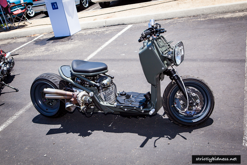

Gil wrote: It depends on how strong the engine was designed to be. All engine have a limit on how much extra HP can be made with OEM internals, some more than others. Only way to find out is to try it. No one here has done a turbo on a stock internal of Honda PCX engine, or a turbo for that matter.
Coming from the Ruckus Scene, Couple people tried Turbo on GY6 150cc engines. Not enough air to actually spoon even the smallest turbo.
Standard Functions did a Zume 125cc swap into a ruckus. Bored it out to something over 200cc and made a couple PSI of boost.

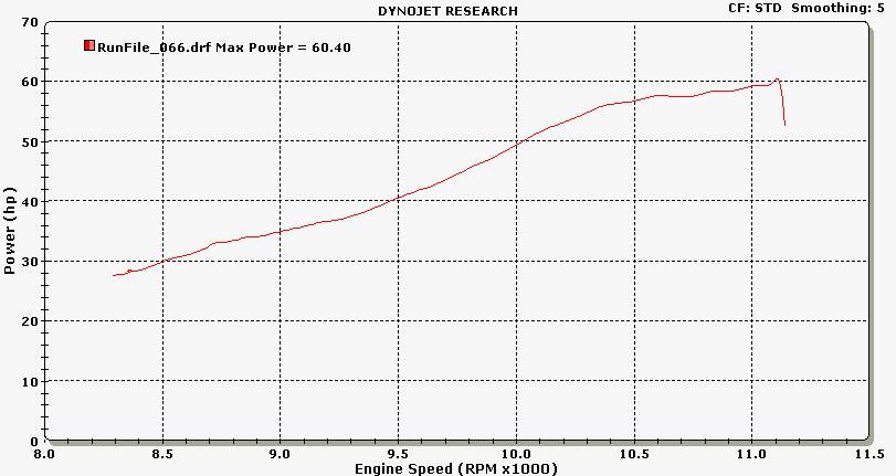

Properly engineered turbos, plural, do work if you know what you are doing. Checkout this project out, a turbo compound 125cc salt lake racer motorcycle. Custom turbos were used to get the 45 psi of boost the owner wanted. He is pushing 60 RWHP.
https://www.facebook.com/POST100
http://post100.com.au/the-motor/
http://post100.com.au/development/

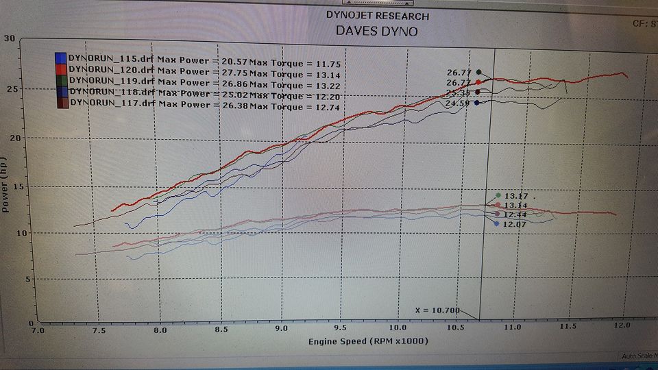

14 PSI with a single turbo, he is getting 28 hp. Look at that custom exhaust turbine housing.
https://www.facebook.com/POST100/photos ... 320498042/

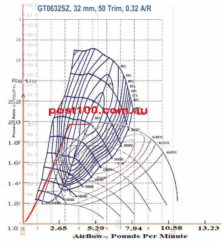

One last post. This one graph is of the stock Garrett GT06 turbo and the one with the custom turbine exhaust. The stock Turbo seems to be just right for the RPM range that our scooters run at.
https://www.facebook.com/POST100/photos ... 863442258/
Blue line is the stock GT0632.
