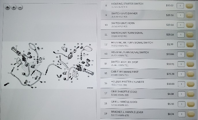

More (in this case) is better - gaw head, "Show" him "the part" fish.
Within this thread I added a link for the op. I'm wondering if you clicked/read through it. Re: my brake light switch cable part #14(on my 2015, that I replaced) awhile back.
SHOWN is for Model 2013
2013 PCX brake light switch cable.jpg (65.38 KiB) Viewed 2140 times

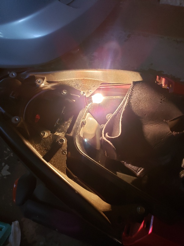

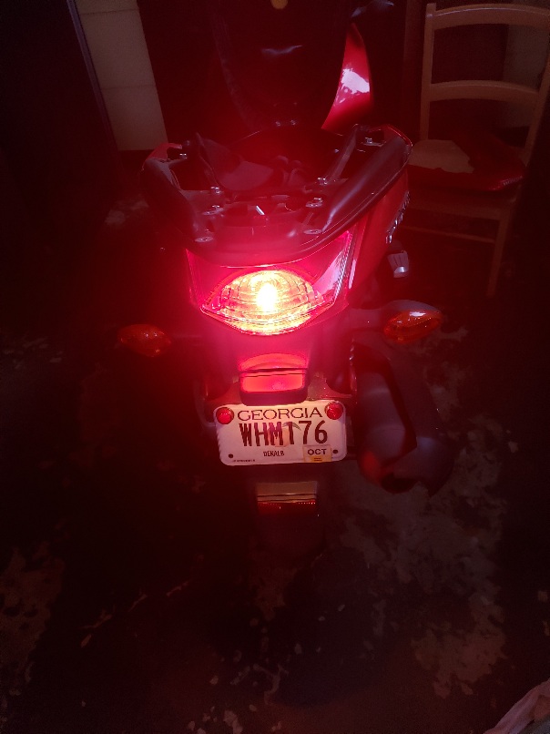

It didn't work, but i tested another light bulb just in case and it worked.
Thanks so much for your help everybody.

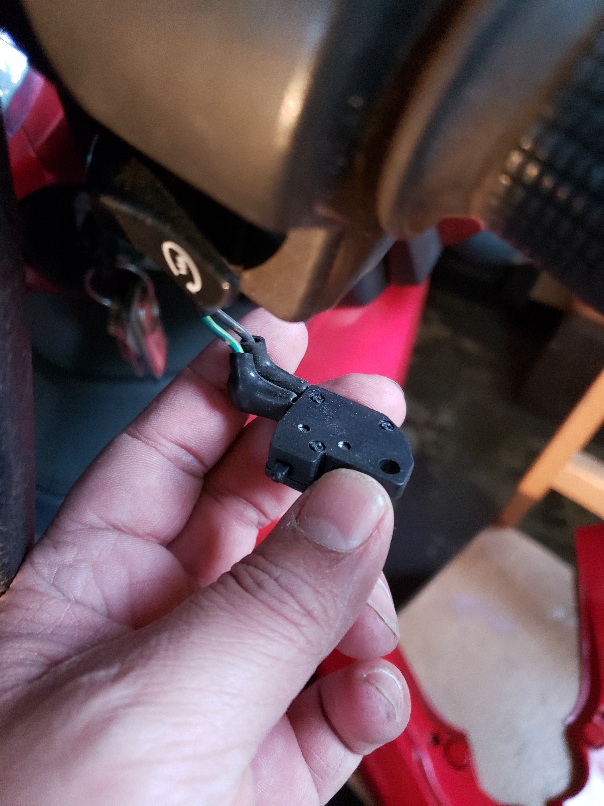

It was the switch.

by kabutomz
Showing the switch i replaced
