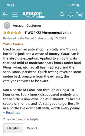

Well now, Looki here..
Undue back pressure Partially plugged up my CAT with Lucas fuel injector cleaner and “Lubricant”
the 2nd part of that injector cleaner, did the bike in..
Well that’s another $500 bucks, it has a catalytic converter in it how nice..
So i ordered a Jug of CATaClean
If that doesn’t work, i am Drilling through the catylst with a long bit
and plugging the entrance hole with a screw or something
Not buying some Loudass muffler to put on it
- 46BE3046-D547-44D4-B9C7-CE1EFA52BFE1.jpeg (337.76 KiB) Viewed 6605 times
