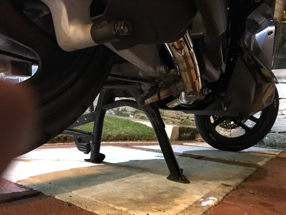

All I have on my bike is the:
Tsukigi RRGS Exhaust => Here
Yumi 164cc kit
Yumi 150cc head
Yumi 31mm throttlebody
Yumi Type B 6 Hole light bore fuel injector
Yumi Type B Manifold
Yumi Variator
8gram rollers and can still hit 120km/h or 74mph with stock gearwheels all while getting up to speed very quickly thanks to the light rollers.

JaeMelo wrote: All I have on my bike is the:
I've always wondered about that exhaust. Is it much freer flowing than a stock exhaust with a cat?

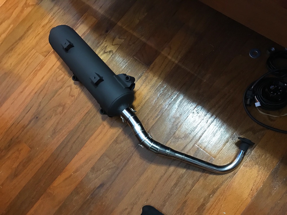

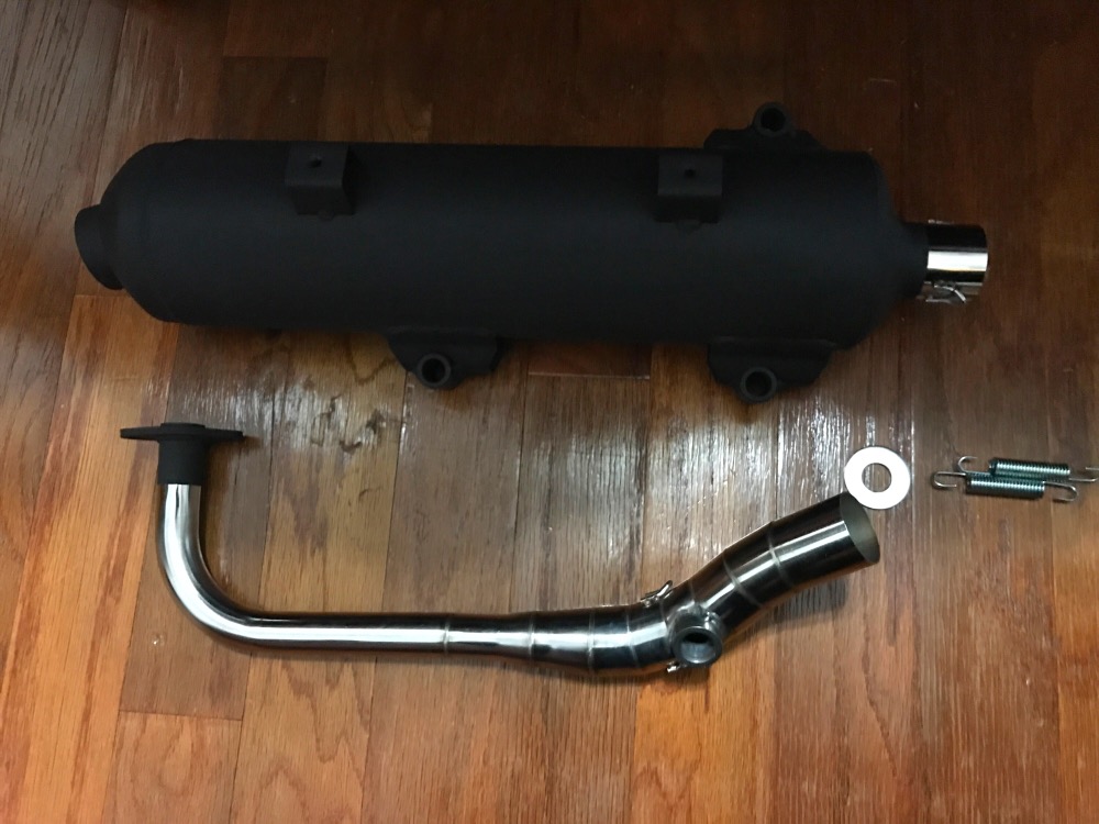

Gav, I brought one of those home in my suitcase last time when I was in Indonesia. It is a straight through flowing end can , unlike the stock multiple canister setup. However reality is different from the marketing pictures. I guess, you get what you pay for. The build quality is definitely not par with the other aftermarket ones.
Remind me if I'd forget, I'll try to make a few real life pictures of the one on my shelf.

Oyabun wrote:Gav, I brought one of those home in my suitcase last time when I was in Indonesia. It is a straight through flowing end can , unlike the stock multiple canister setup. However reality is different from the marketing pictures. I guess, you get what you pay for. The build quality is definitely not par with the other aftermarket ones.
You did not get this exhaust then haha. I have 2 of them an they look exactly like in the picture down to the T.

Jaemelo: I'm pretty sure I've got the same exhaust. And from the same distance it looks exactly the same as the one on the pictures. However there are things which are not visible on the picture. The clamp to fix the pipe to the exhaust port is mild steel welded to a stainless pipe, and the cutout is mediocre re at a bare minimum. The welds are definitely not up to the level of a brand name aftermarket exhaust. The stepped part of the pipe before the can is looking great, but in reality the sliced and steped part is only welded on top of the same diameter pipe as the first elbow part. The end can looks OK, but it is made out of mild steel and has all kinds of unfinished - like stuff like not treated cut edges and so.
All I'm saying is that one gets what one pays for. It is certainly more than what I'd get for 50 usd plus shipping here - or in other words worths more than 1/6th of a Yoshimura.

Post by JaeMelo »
^Ehh just to make sure your exhaust looks exactly like this and says RRGS on the top?! The only reason I ask is because a few of the points you made I am having a hard time seeing on my own. Specifically where you mentioned "but in reality the sliced and steped part is only welded on top of the same diameter pipe as the first elbow part". I can however agree on the welds not being absolutely perfect. However I have a hard time even regarding that as "a thing" seeing that the bike's side stand and main stand welds look the exact same; even some parts on the frame.
