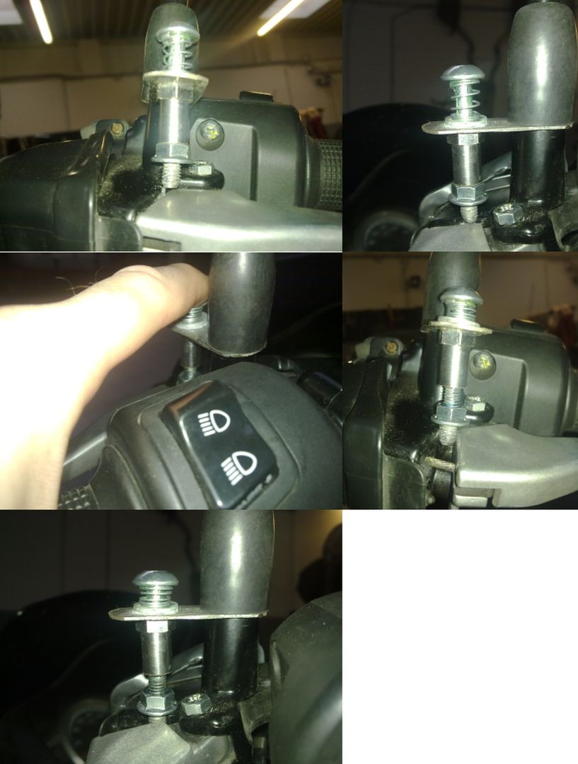

Have built today a own parking brake. Function: Pull the left brake, push the screw with the index finger into the column, release the brake.
When you start, pull the brakes, the spring automatically brings the screw into the initial position.

Seriously... you two guys have too much time on your hands
Actually as cumbersome as that looks it is an improvement on Honda's p-brake because it auto releases. Congratulation on a better mouse trap bro! But you still might get this years nut award for silly modification
Wait... the more I think about it, I might make you a whisper'er for that because it works better than mine.
