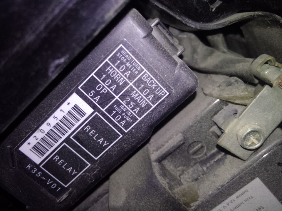

My new PCX has a problem with lighting up when turned to ignition.
Do you gents know which fuse controls the power supply to this junction i.e. "when turned to ignition, the system should light up"?
Thank you.
Thank you.

I think most likely should be the "OP", second likely the "ignition fuel pump"
I am not sure. I am thinking the fuse might have a problem.

@Dole the PCX is fairly simple when it comes to electronics.
If it is a fuse and it has a headlight problem, it is either the 25A main fuse, or the 10A one with "head, turn, stop, meter" written on it.

I today got this problem solved.
First, I tried numerous times to start this scoot, finally the system got on, and I couldn't wait to ride it to a suzuki dealer about 10 miles away.
the service gentleman was very kind and helpful, he told me the connections to the battery is totally wrong, and he reconnected them, and the PCX is as good as new.
Extra information: it is not Honda problem, it is the seller's problem, because the battery was not installed when shipped from Honda Thailand, it is the seller who installed the battery before shipping to buyer.
