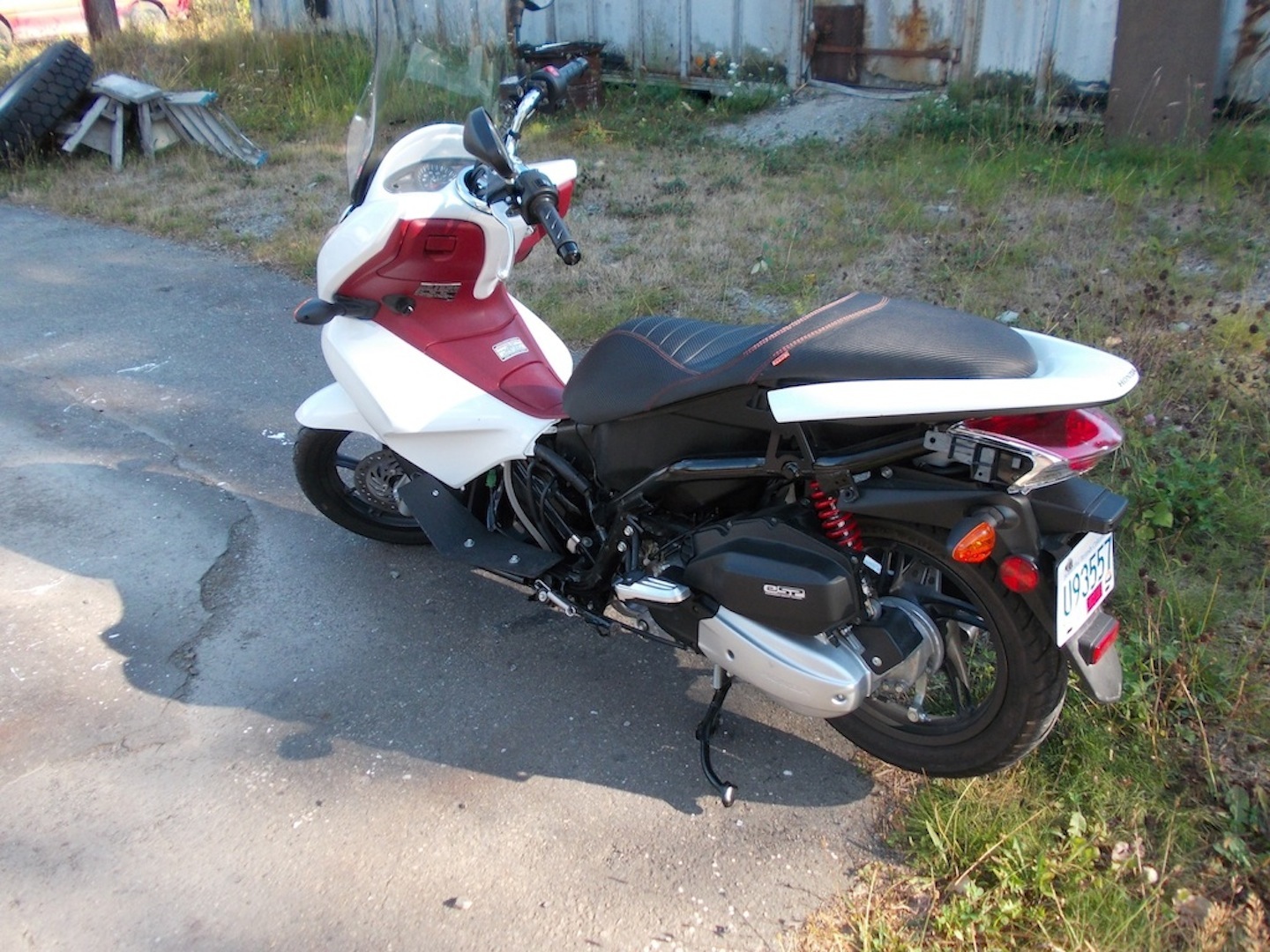

might be a simplistic redneck solution-but why put the plastic back on?
fabricated some floorboards out of some flat bar I had hanging around- the bike is fully functional
might not be every ones cup of tea but playing with something akin to a Rubiks cube
aka plastic body parts makes no sense to me
