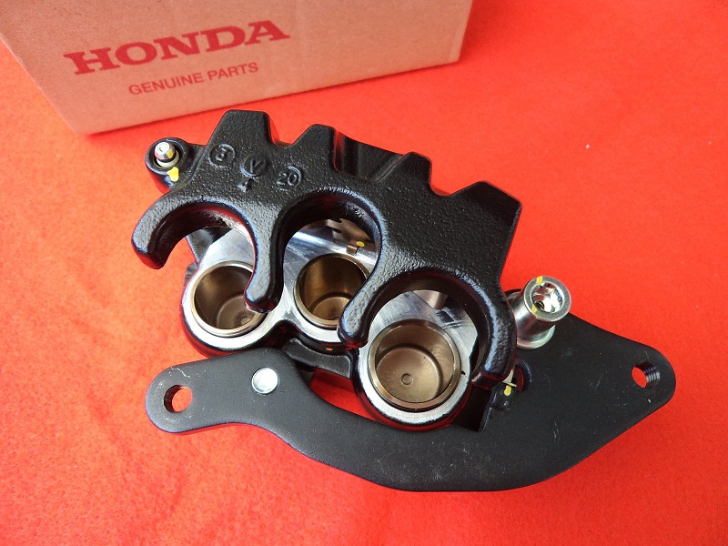

Yours might be different, but I've only seen calipers like the one on the picture, and on these the two identical pistons are the trailing edge of the front brakes, and the center which is linked to the CBS.lolofigo wrote: I've got 2012 pcx 125 and two pistons operating on front lever look the same haven't measured them if they same diameter but middle one that operates with CBS is significantly smaller.
The larger one is the leading edge of the front caliper. Mind you the two outer ones look identical from the casting side, but the piston diameters are different. Also the parts catalog supports this.

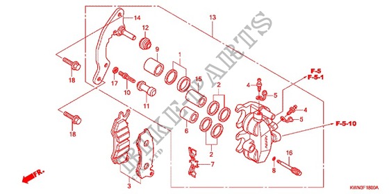

- Parts Catalog listing identical seals and pistons for center and one outer piston
- sea.jpg (39.76 KiB) Viewed 13859 times
- Center and left outer piston has identical same diameter
- caliper.jpg (171.95 KiB) Viewed 13859 times
