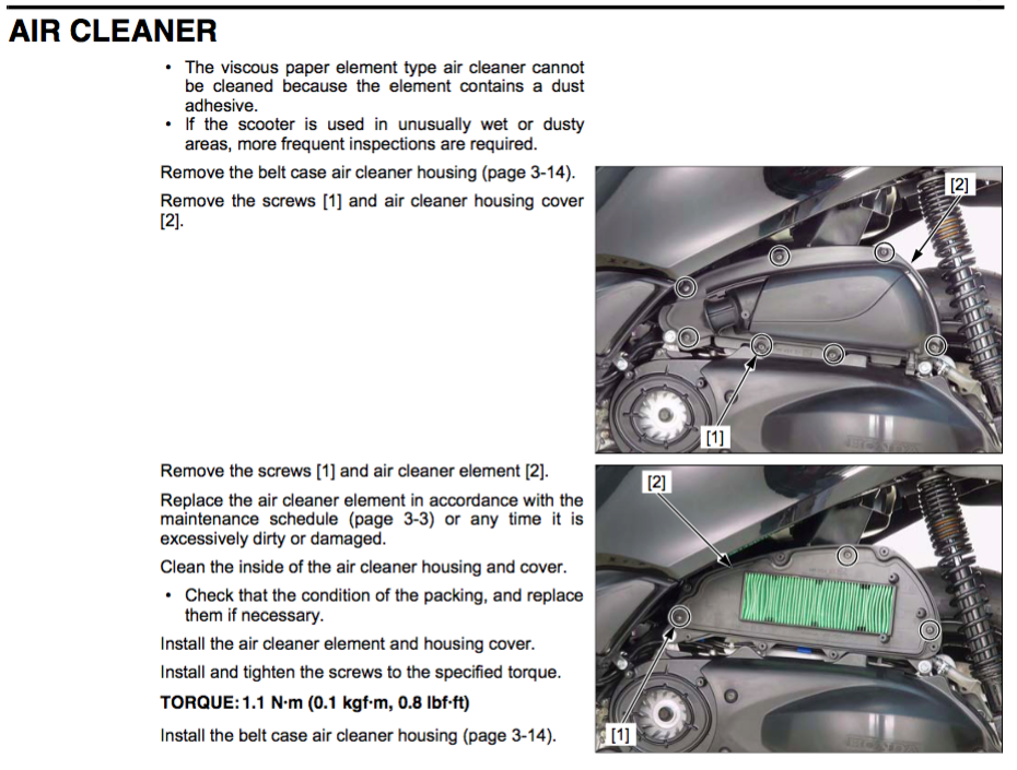

I would like information about the air filter location, type & replacement.
I tried search using + air + filter & all I get is you can't get there from here.
air filter on Forza.

This from page 3-5 of the shop manual:
- Screen Shot 2016-09-10 at 10.16.49 PM.png (609.74 KiB) Viewed 1343 times

One source in the US (we can't see where you are, so we can only tell you what we can get where we are):
http://www.hondadirectline.com/OEMpartf ... K044F2800A

Re: air filter on Forza.
Good. That looks MUCH easier than the two air filters on my Majesty. I am considering getting a new scooter & that was one of my concerns.
