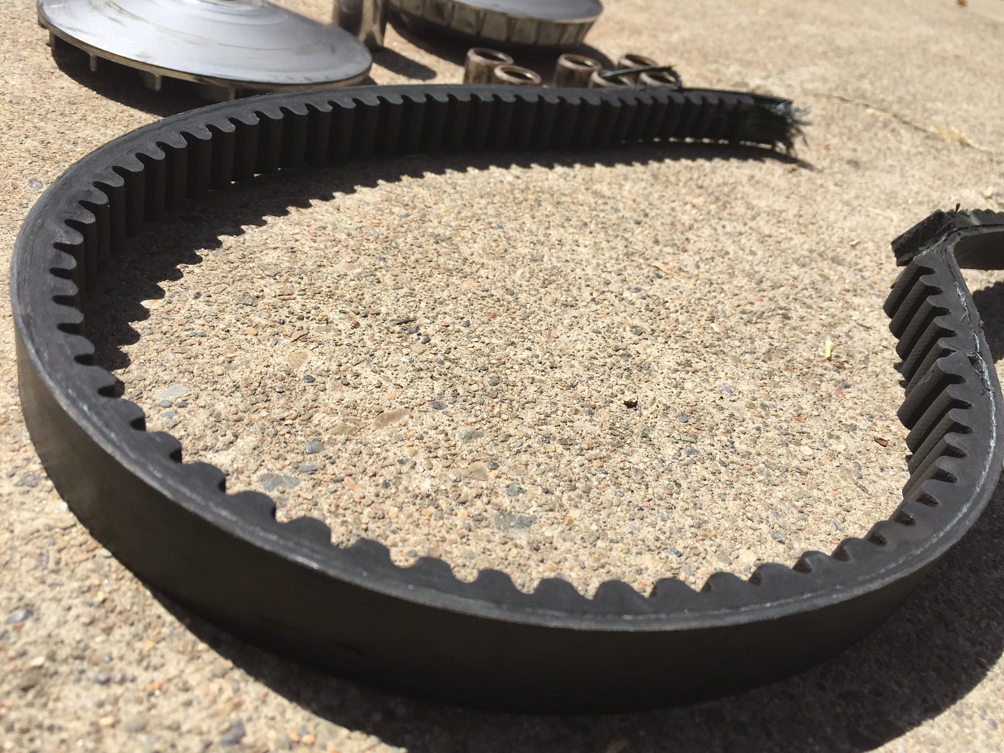

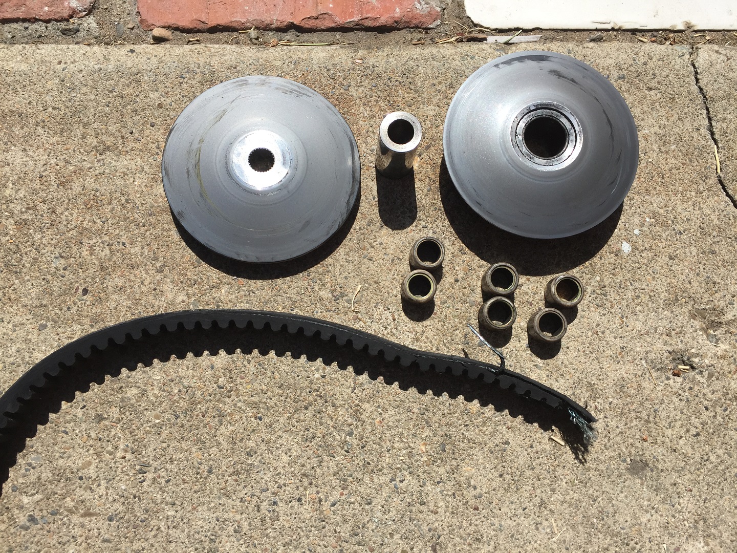

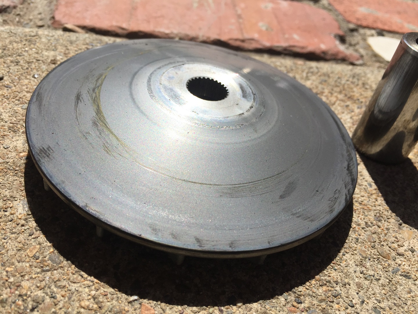

OK - Pics!!!
Most interesting to me is that the belt seems to be in such good condition where it isn't actually snapped...
Marks on the variator could have happened post-snapping... but they're on there pretty good since I've already done a once over with some brake cleaner to look at the face without grime...
Not sure if there is much to learn here or not - happy to post more pics if anyone thinks it would help.

Looking at this, I wouldn't think anything but defective belt so far.
Re: Aftermarket Variator + Drive Belt = Failure at ~3,500 mi
If you look at the edge of the belt you can see where it was rubbing against something. On the variator itself it looks like the belt stayed in the middle a lot, which is good, but then it also shows signs of the belt riding on the outside edge. I can't tell if the obvious marks on the outer edge are just from when the belt broke, but if you look closely it looks like there is some wear on the outer edge of the variator as though the belt has ridden there normally too. Aside from the broken belt, I don't see much out of normal except the possible marks on the outer edge of both the belt and the variator.

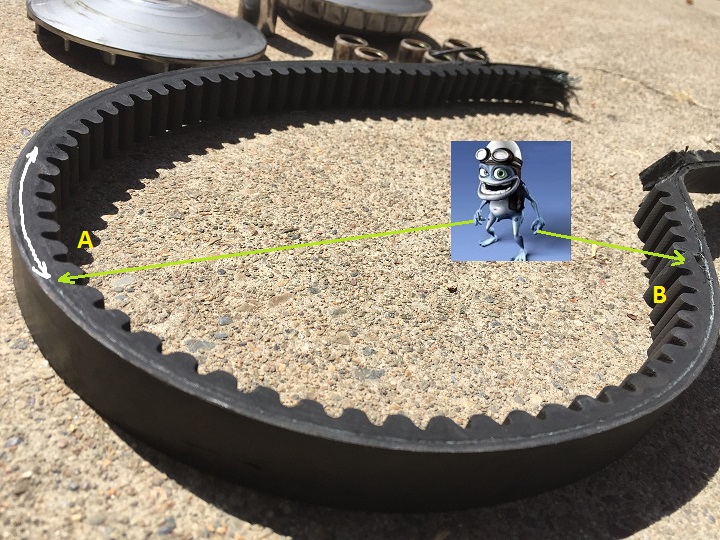

I see it now Mel, you might have it right. The Yuminashi kit squeezed the belt up over the edges of the faces and this caused separation stresses along the line shown in example 'A' like where it was about to happen in example 'B' and did happen where the belt broke.
Am I getting this right? You can't ride your belt over of the faces or you suffer premature failure at the gain of short term performance enhancement. About 3500 miles with Yuminashi

Nobody is going to want that... unless you are racing other PCX's
Put in another belt, maybe a cogged one or go to NCY kits.

Ahhh, so the Yuminashi must just squeeze the hell out of the belt up past edges of the variator and drive face. They do claim the highest speed, so that's one way too do it. Looking at the pictures there's a wear line in 2~3mm from the edge of the belt, probably where it was proud of the pulleys.Eiron wrote:chicaboo, unlike the NCY "assembly", these Yuminashi kits come with both the variator & drive face halves of the drive pulley assembly (along with a new boss & 10g rollers). But I think you're absolutely right that having mismatched face angles would cause issues!

Gregory Stuart asked me to take a look to this conversation, so thank you for the head's up Stuart, and after doing so it makes me think that the heat of the engine make the belt snap.
We have spend a lot of time and effort to find the right balance between allowing the belt to rise and higher RPM's to gain top speed.
Most companies let the belt rise until the belt is stretched so much so that it finally will snap, our variator have literally build a block in to avoid this, so that the belt can't rise anymore at a certain point, and the RPM's need to take it over then to gain more top speed.
You can see very clear on the displayed pictures here that the 2 variator halves are touching each other, hence slightly damage on the fixed drive, near the center of the variator.
So when the two variator halves are touching each other, the rise of the belt is blocked at that moment and it can't rise any further.
That's the moment where the RPM's need to take over to make more top speed.
We did several tests before, and we had one certain moment with a engine configuration where we where able to make a brand new original Gates Powerlink belt snap in less then 20Km time with a engine producing a lot of heat.
We improved the ventilation on the cover with machining a part out of the cover at the very end from the cover (right hand side once installed) to have a gap for the ventilation, and we didn't snap the belts anymore on that very same bike without changing anything on our variator.
Before we did that, we snapped at least about 5 belts on that bike.
So we changed nothing on our variator, only improved the ventilation/cooling capacity for the belt.
Our variators make a perfect fit with the angle from the v-belt, so we don't use 14 degrees or 13.5 degrees flanks because we know that this would eat v-belts and will make snap your belt very soon.
Talking about our variators which would allow the belt to rise to high is a non fact and out of order, this isn't happening, we block the belt..

- traffic was fairly frequent - especially going home (California San Francisco Bay Area) - not an aggressive lane splitter
- Bike was 2016 absolutely stock except for GIVI screen and B47 topcase (plus obviously the variator)
- installed myself using torque wrench and stupid variator tool that falls off... ugh...
Some outright performance stats I stand by:
- never saw higher than 78
- never hit the rev limiter after I installed the Yuminashi part
- in stock form, before the part I felt like maybe I got lucky with a strong motor or did a good break-in because hitting the rev limiter was something I constantly had to watch for and it was very annoying - which of course was 63-64 mph (WHY?!?!?)
On the day:
- ambient temp probably low 70s Fahrenheit (not hot I might point out)
- going up slight grade, no traffic, approximately 60mph into a headwind (close to WOT)
- just finished a flat section also with no traffic into headwind but stayed in slow line and was probably mostly under 60... I do have some mechanical sympathy
Anyway - happy to keep answering questions but just to satisfy curiosity I think more than likely I got a bad belt and nothing more, as homie first opined right after I posted pics. Don't think anybody really has anything to answer for
Ride safe all!
