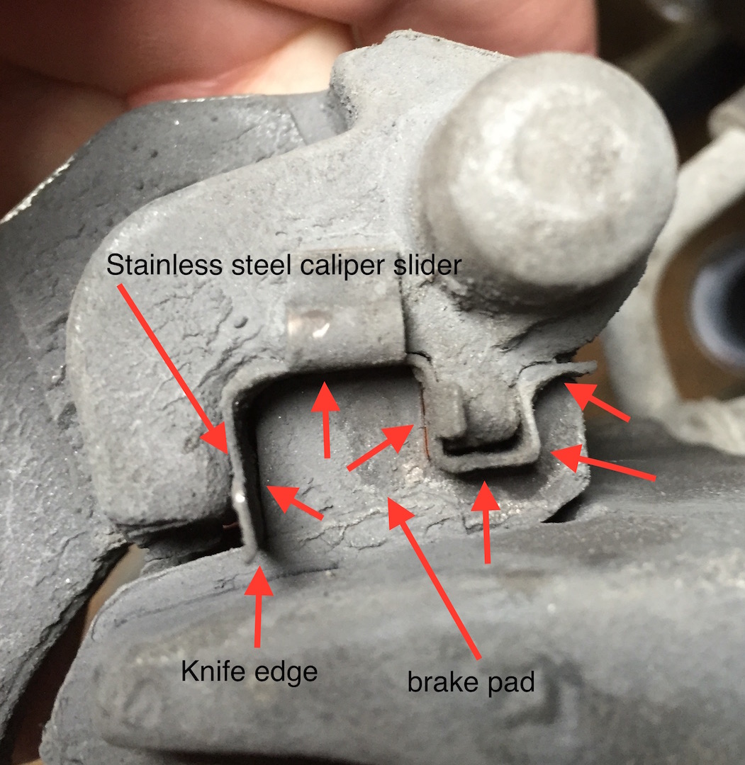

I finally had the parts I wanted for my Forza after a few tries. I pulled the rear calliper off and the brakes were ruined again. The inner pad was down to the metal and the outer pad was almost brand new.
What causes the calliper to stick like this?
