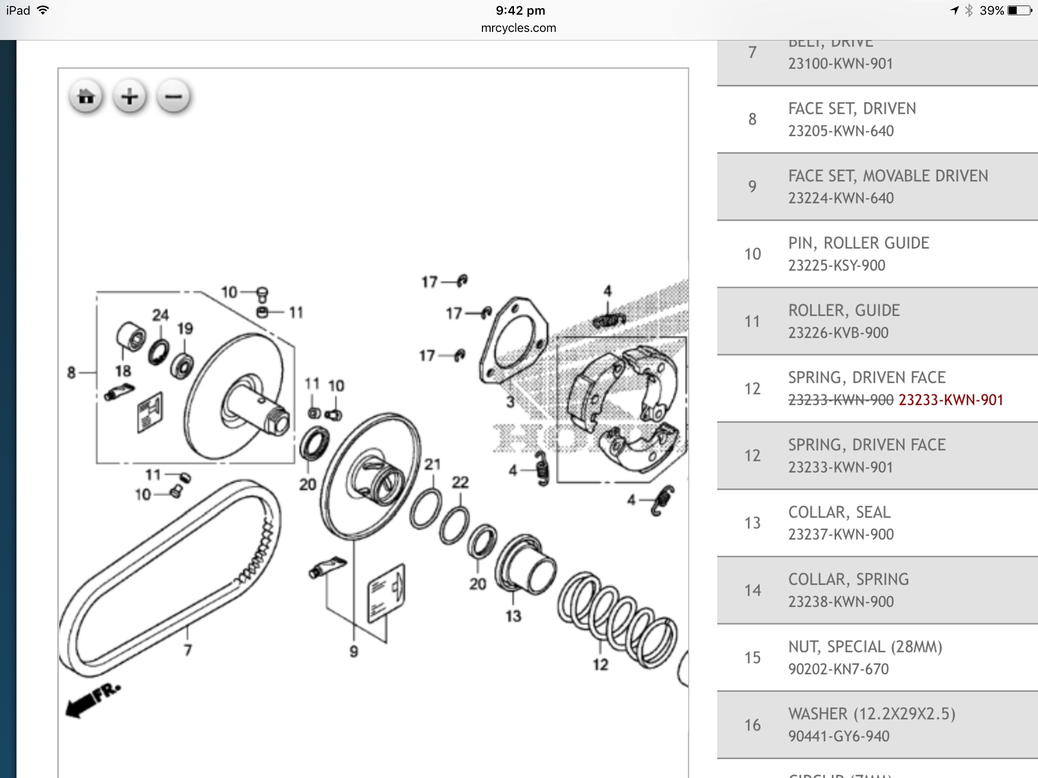

Re: Rear wheel noise - URGENT!!
It just could be the bearings are worn in the clutch pulley. No amount of grease will fix a noisy worn bearing.
If your not sure what your doing best take it to a qualified person to get it checked.
There are a number of pcx owners on here that have had a similar complain and it was the bearings.
Items 18 and 19 are the bearings but I replaced the pulley, item 8 as I didn't have the tools to get the bearings out.
I got mine from Webike. It came from Japan so vat and import duty applied but it was still cheaper than the dealer.
The cheaper option would just to replace the bearings. A blind bearing puller is required to get it out apparently but do doubt someone will have a way round it.
