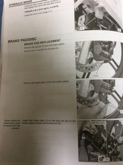

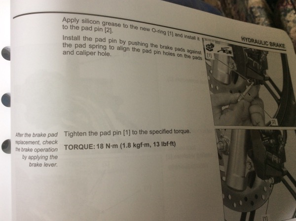

Looking at the manual, which I didn't have access to when I gave my original response you don't even have to remove the caliper to change the pads.
See attached pics
- image.jpeg (59.2 KiB) Viewed 4078 times
- image.jpeg (63.42 KiB) Viewed 4078 times
Re: Changing brake pads - PCX 125 2013
The pads are teeny!
Looks like it couldn't be simpler tbh

you you wrote:The pads are teeny!
I have to say, kudos to Honda for making it easy.
honkerman wrote:you you wrote:The pads are teeny!
