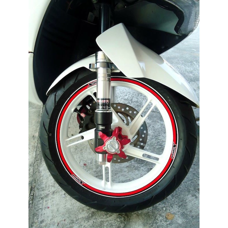

I was wondering if the trusty fork bottoms had more/less clearance, and if anyone had tried them?ruddick wrote:The PCX wheel and tire change problems are now behind us with the help of the very nice guys at X-Speed Bangkok. The IRC 110/90-13 was a no go and as suggested on this forum we ended up fitting a IRC MB99 130/60-13 on the front and an MB99 130/70-13 on the back. Also replaced the rear shocks with YSS Z series 310mm XXL adjustable gas shocks. Once the tire pressures were set the bike ran like a dream.
Only problem with fitting the 130/60-13 on the front was that a very small amount of grinding was required to ensure the tire didn't rub on the inside of the forks.
For those of you who are wondering why we changed the stock wheels and shocks etc. I have enclosed a photo of the rear wheel after the encounter with the pothole.
Once the bike is washed and clean I will post a photo of the completed bike. We are located in Bangsaen Beach, Thailand.
- trusty.jpg (131.71 KiB) Viewed 1709 times

Re: Fitting 13" wheels and wide tires on PCX 150
Just about the same clearance. 105mm fattest section. 120mm widest. These forks are a definite nono for grinding out though like the other guy did. Very thin top section.k2apache6.0 wrote:I was wondering if the trusty fork bottoms had more/less clearance, and if anyone had tried them?ruddick wrote:The PCX wheel and tire change problems are now behind us with the help of the very nice guys at X-Speed Bangkok. The IRC 110/90-13 was a no go and as suggested on this forum we ended up fitting a IRC MB99 130/60-13 on the front and an MB99 130/70-13 on the back. Also replaced the rear shocks with YSS Z series 310mm XXL adjustable gas shocks. Once the tire pressures were set the bike ran like a dream.
