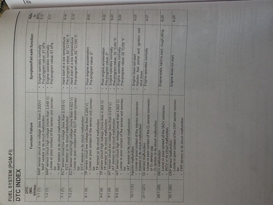

My 2013 manual for PCX 150 says 29 is IACV malfunction. It reads a loose or poor contact of the IACV connector or, the Idle Air Control Valve or its circuit is malfunctioning.

jims wrote:My 2013 manual for PCX 150 says 29 is IACV malfunction. It reads a loose or poor contact of the IACV connector or, the Idle Air Control Valve or its circuit is malfunctioning.
Sounds more like it.
I read it as 9-2 not 29 so it depends what way around it is. The 29 code makes more sense.

just putting my 2 cents on this very old thread, but the manual states that 2 long flashes = 10 short flashes. So 2 + 9 = 29 which is indeed an IACV error.
