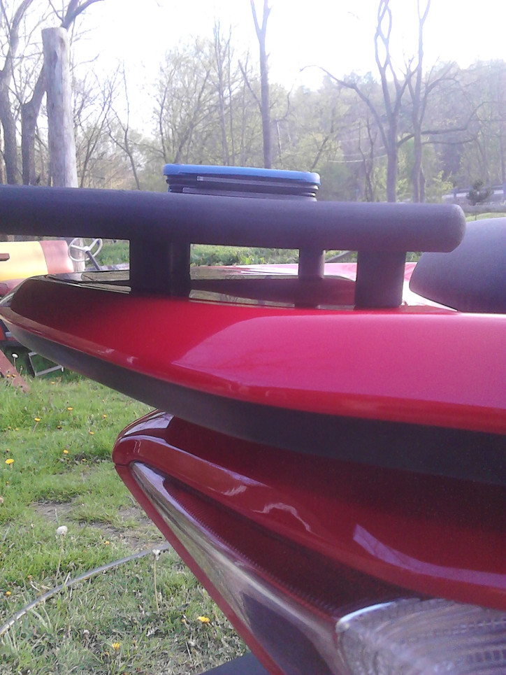

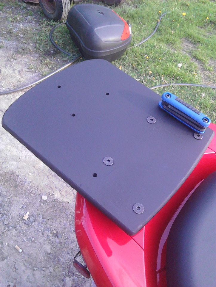

The cutting board trimmed and drilled

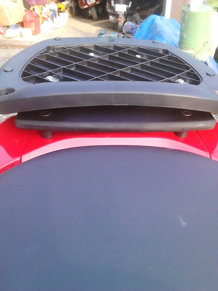

Spacers
The universal mount that came with the trunk

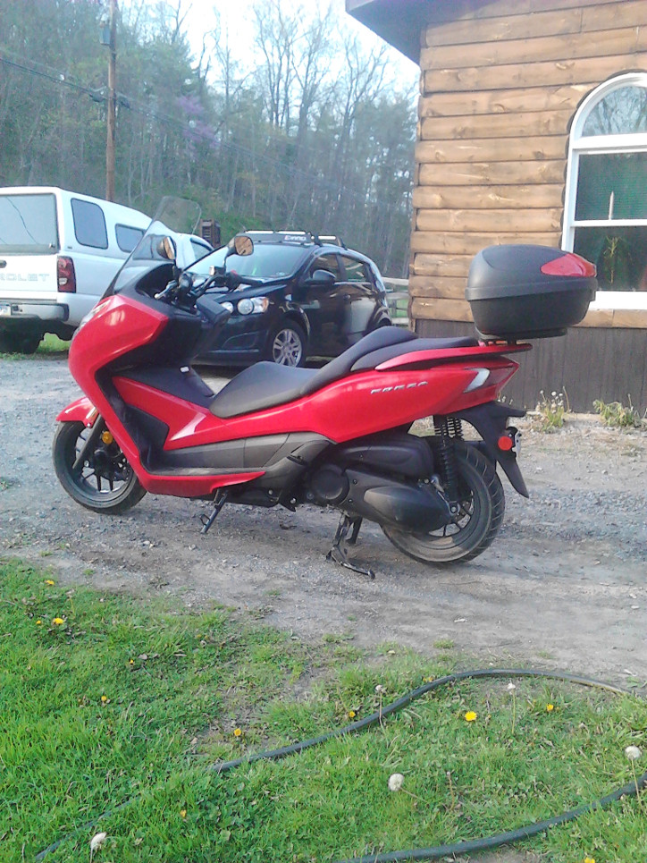

And we're done

This one is made out of a bamboo cutting board. I ordered a poly cutting board from ebay but when the trunk came and the board still hadn't shipped, I got antsy and went and bought the bamboo one at the local hardware store. It said on the package that bamboo is 16 times stronger than maple and that was confirmed by a friend who is an avid woodworker, so that's how that all worked out. If this one doesn't hold up, it's easy enough just to do it again with the poly, especially now that I have a pattern.
I really only had to trim the rear. I didn't touch the other 3 sides. Once I had it mounted on the bike, I positioned the universal mount where I wanted it, drilled the mounting holes and traced the rear line. Then I removed the universal mount and cut the excess off of the back of the board with a jigsaw while it was still bolted to the bike. After that I just hit it with the sander to smooth it out a bit, removed everything and painted it, waited for it to dry and then bolted everything together. Total time was prolly 3 hours.

Post by romei »
I have to report that the quality of this trunk is much better than I was expecting. It is much better than the little cheapies I have on my smaller Chinese scooters. I hope I never find out if it would survive a fall like in the video above, but I think it would. It is removable via a thumb screw from the inside and it has a handle built in so that you can carry it like luggage, but once you set it on and screw it down, I don't see it going anywhere.
