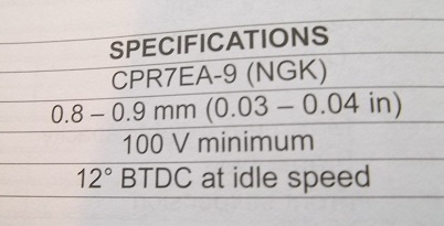

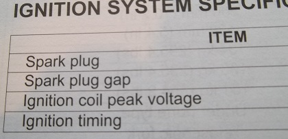

Hello and a pre-thank you for your help.
To keep it simple, which plug will fit the PCX and/or are these the same part? I have been searching all over google for the info. The closest that I can come to is one is sold over seas, and one is for the USA, but hopefully they are the same part.
NGK CPR7EAIX-9 4848
NGK CPR7EAIX-9 9198
Thanks again for your help
NGK CPR7EAIX-9 4848
NGK CPR7EAIX-9 9198

Re: Spark Plug Part Number Help
- 100_2970.JPG (123.02 KiB) Viewed 12383 times
- 100_2971.JPG (106.18 KiB) Viewed 12383 times
Most of the info I found on the CPR7EAIX-9 4848 is from other countries and CPR7EAIX-9 9198 is mostly from the USA.
Specs seems to be close if not exact, but I just want to be sure.
Thank you.... Thank you
Yes, that is the stock/oem plug. I was looking at the iridium plug.homie wrote:this is your spark plug
http://www.amazon.com/gp/product/B001RM ... UTF8&psc=1
I will check out the specs and see if they match up.
Thanks for your help
