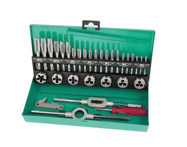

Thread tap..... the Exhaust Bolt.... the thread/hole on the Swingarm, what size is that? I just bought a Thread tap set and the largest is M12, is that the size I need?

Totally forgot i'll need to get a thicker bolt if i'm going to tap the thread!! not sure what the size of the one is now,

All you need is a thread repair kit. It would be a very easy job in your case since you can get right at it on the side of the bike. You have no issue with access to the repair with the exhaust off. Measure one of the good bolts to determine what size you need.

I bought a thread tapping kit, the biggest in there is m12 though,
I was told that if you use it then you have to make the actual hole bigger? so i'd need a bigger bolt...
i'm not sure on the current bolt size (its the stock bolt) as it's been raining so I haven't been able to check the Bike,
big if I get a bigger bolt, then i'm not sure if it'll go through the actual mount on the Exhaust itself.

A helicoil insert is a new thread, the stripped thread hole is drilled out, a new thread tapped in, then a new thread insert is fitted in to restore the hole to the original size.

This is what I had...
Screen Shot 2015-10-10 at 20.54.33.png (302.27 KiB) Viewed 3320 times

A cross threaded and stripped hole is missing some metal that has been torn away. The tap set that you have is useful if you start to crossthread a bolt hole but stop before you go more than a couple turns. All of the metal is still there further down the hole but you have to use a tap to clean up the outer threads so that you can get the bolt started correctly. Once you strip the hole so that the bolt is all the way in but just keeps turning without tightening, you have torn out the metal of the threads. You can drill and tap to use the next bigger diameter bolt. But it might not fit through the hole of the muffler. So it is better and easier to replace the damaged threads with a threaded insert so that you can just use the same size bolt.
You may be able to die the threads on the damaged bolt to reuse it but it is more likely that you will need a new bolt also since the threads will be mis-shapen on the bolt as well.
