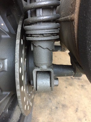

When I first got my Forza I played around with the stock shock settings. I ended up with a full soft setting for my 200 pound self. The full hard was cruel.
