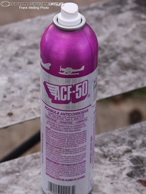

proteinsdef wrote:Never heard of ACF-50 before, sounds good.
I choir that!
No power washer, it will do more harm than good! So glad and smart of you to ask here first ;)
What the ACF-50 can looks like:
