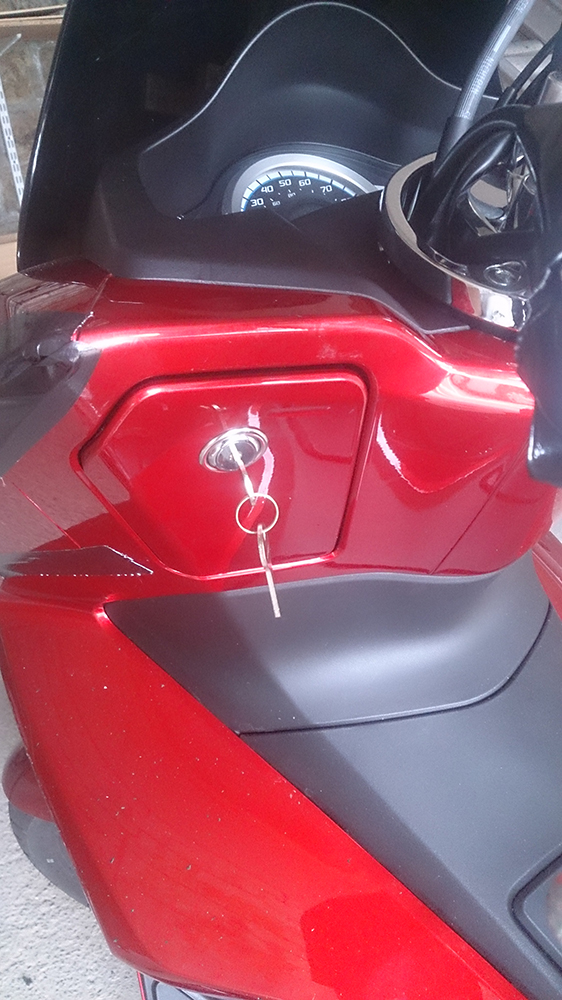

- The after.
- DSC_1223.JPG (386.95 KiB) Viewed 15116 times
- And done.
- DSC_1224.JPG (428.93 KiB) Viewed 15116 times

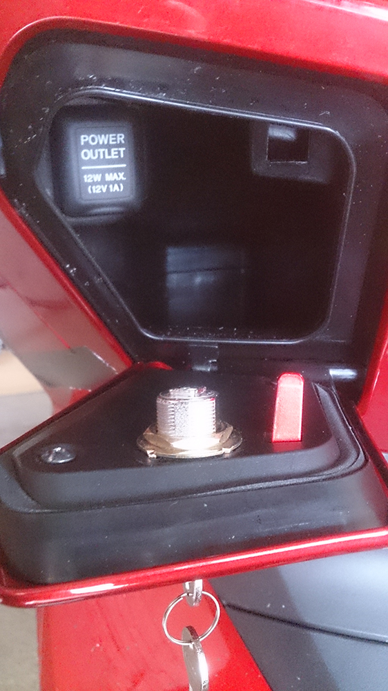

- Had to fashion, bend and shape the Cam lock arm to fit. also included a small strip of weather proof foam to hold the lock tighter.
- DSC_1225.JPG (390.07 KiB) Viewed 15116 times

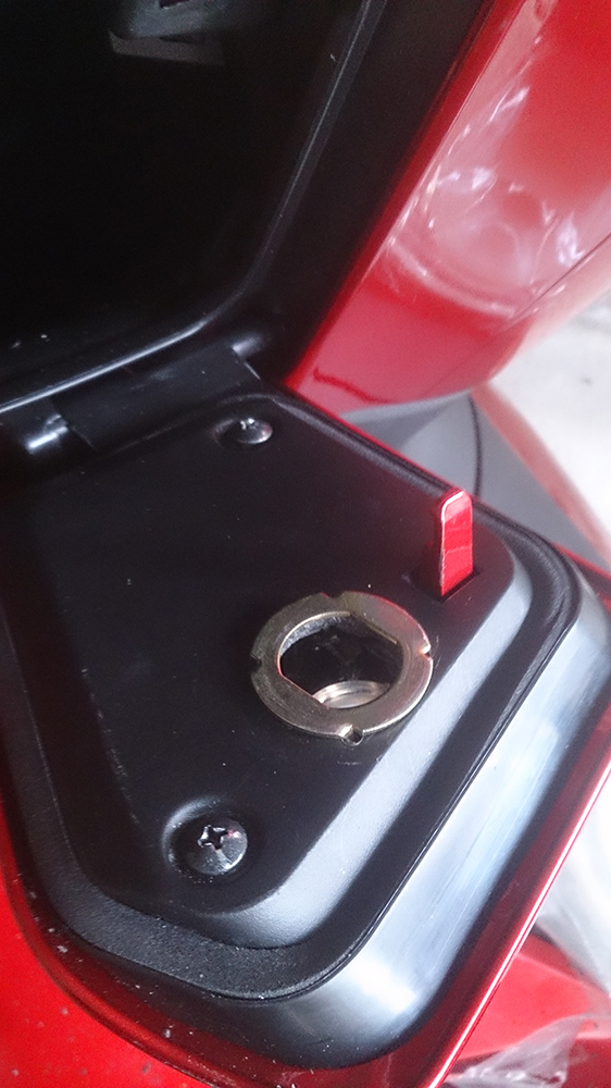

- Cam lock held in place.
- DSC_1220.JPG (432.26 KiB) Viewed 15116 times
- backing plate with some sink holes below the clips.
- DSC_1218.JPG (369.53 KiB) Viewed 15116 times

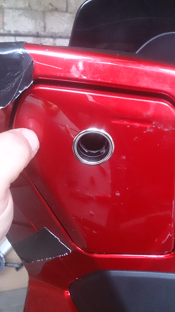

- A cover for the hole.
- DSC_1217.JPG (398.96 KiB) Viewed 15116 times
- DSC_1216.JPG (391.85 KiB) Viewed 15116 times

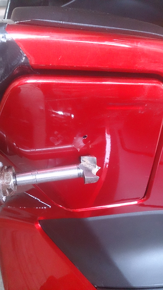

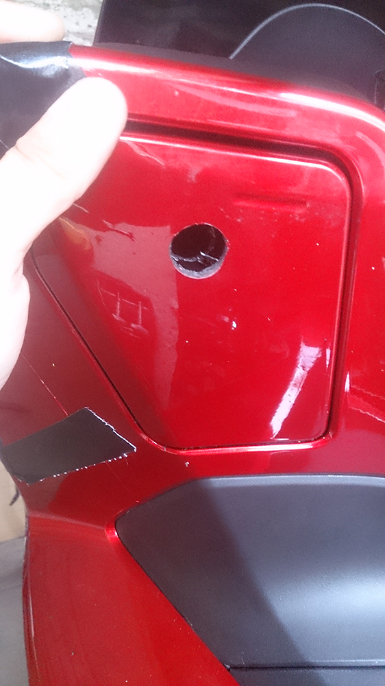

- Using a 20mm bit.
- DSC_1215.JPG (412.85 KiB) Viewed 15116 times

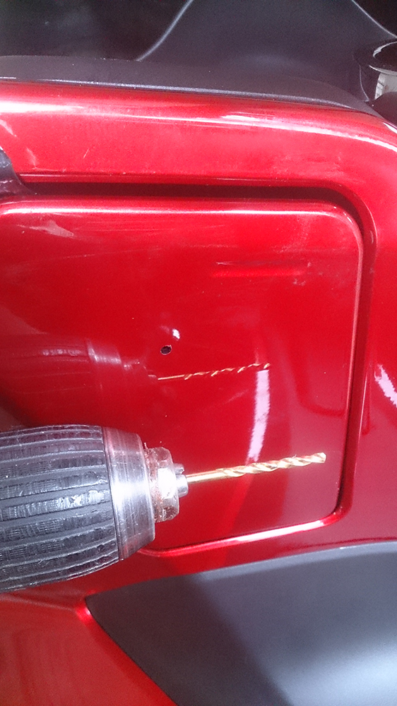

- After measuring the Cam lock I drilled a small Pilot hole.
- DSC_1214.JPG (436.1 KiB) Viewed 15116 times
- DSC_1212.JPG (379.91 KiB) Viewed 15116 times

Hey, you could do this sort of lock on any model but not the same way. The 2015 model has an internal "lip" at the lock arm caught behind. as long as the lock arm can get behind a part of the body it'll work. you maybe could cut a channel in lieu of the internal lip.
