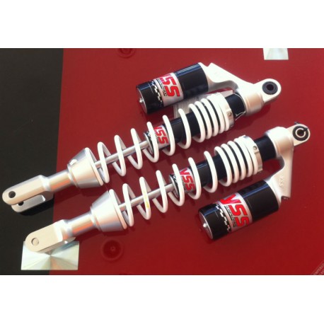

YSS
I ended up ordering these guys. They showed up and I'll get them installed one night this week after work. I post some pics and impressions after riding on them for a couple of days.
- shocks-absorber-gaz-adjustable-white-yss-honda-forza-nss-300.jpg (34.66 KiB) Viewed 10548 times
