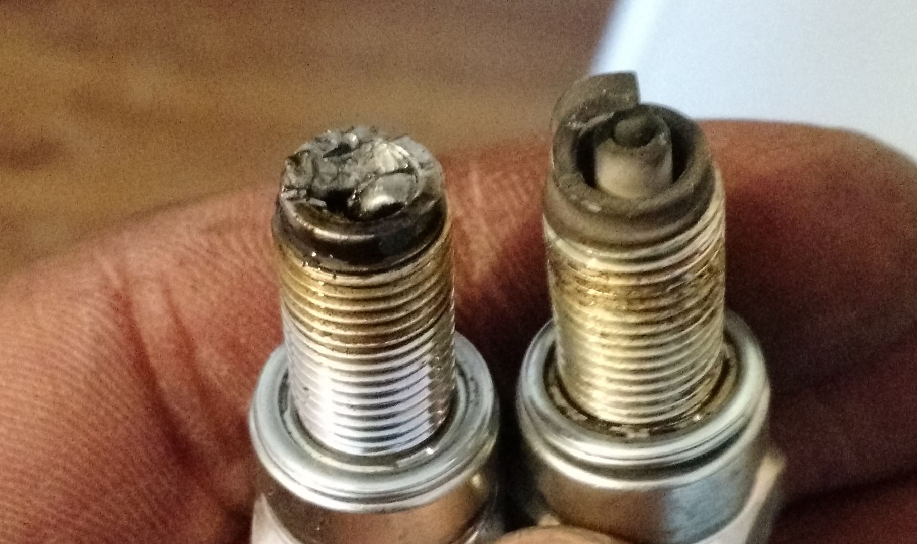

Yesterday I replaced the spark plug, today I broke down, I removed the new plug and found that it had been flattened and (by the piston I assume). The bike won't start with the old plug in, it struggles to turn over with a lot of clanking noises. have I done goofed?

are you saying the piston collided with the spark plug?

I'm guessing so as the damage looked mechanical

Yeah, this is either the piston being connected incorrectly or the wrong plug installed (too long)
I would say a dealer visit is next.....
Re: Overtightened Spark Plug
What plug did you fit and what was the original plug?
If the replacement plug was too long and the piston has hit it, your engine could be toast.

NGK CPR7EA-9, got it from a Honda dealer,

Here are the plugs, new and old

Wow....thx for the pics, keep the recept for the plug, you may have a case if its the wrong plug....
Do they (or did they) look to be EXACTLY the same length?
If the new plug is the same model as the old plug and the one you got is definitely marked on the plug as the right one, (not a wrong one in the right box) I don't see how overtightening it could have got it far enough into the cylinder for that to happen.

Jge64 wrote:Wow....thx for the pics, keep the recept for the plug, you may have a case if its the wrong plug....
I am 90% sure they were the same length, I have put my tools away for now, and the old plug is in the bike, I will take it out and compare what is left of them later.

gn2 wrote:If the new plug is the same model as the old plug and the one you got is definitely marked on the plug as the right one, (not a wrong one in the right box) I don't see how overtightening it could have got it far enough into the cylinder for that to happen.
I followed the instructions in the user manual, 1/2 a turn, loosen then 1/8 of a turn.
