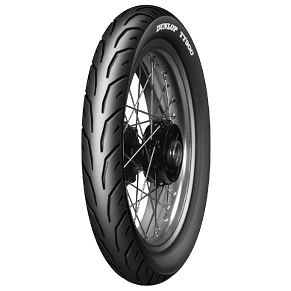

http://www.oponeo.co.uk/Temp/dunlop-tt9 ... 00-sk3.png
This is what a new one looks like.
If yours has no centre groove,, its long past time for a replacement.

Thanks for the photo. My front tire has the center groove. When i got the bike (used at 2,000 miles), the rear tire did not have a center groove. The diagonal grooves are still deep. The front tire is TT 900 F. Rear is TT 900 A. I will check online to see if there is a possibility that the "A" has no center groove; then head to the shop to buy a tire.gn2 wrote:http://www.oponeo.co.uk/Temp/dunlop-tt9 ... 00-sk3.png

I found this photo of a new Dunlop TT. Not the same size as mine but this is what mine looks like.
I hope this image shows up. I tried to drag and drop it. What is the best way to add a downloaded photo to a post? I clicked on "img" on the Full Editor page but the letters "img, img" appeared in my post. The other choices are Bold, Italic, Underline.

Can't explain that right now yak, best I can do is paste it for you.
Gotta leave now.
- image.jpg (45.08 KiB) Viewed 2103 times

Thanks, WhiteNoise. My rear tire looks like the photo. No center groove.
