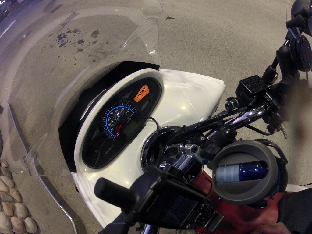

GPS on left, Drink holder in center, Cellphone holder on right.Nexxiss wrote:sorry but whats the use of having a ram mount- newbie here

This is what my bike looks like when We are out riding and I have my gps connected. Hopefully my cup holder and cup are not in the way of this view of the ram mount in action.

Nice pictures Mel46. Can you tell me what are the pieces on the side of your scooter? They look like triangular pieces of clear plastic with a black edge on the side of the scooter near where your turning light are located. Are those air deflectors?Mel46 wrote: This is what my bike looks like when We are out riding and I have my gps connected. Hopefully my cup holder and cup are not in the way of this view of the ram mount in action.

Those little triangle pieces are wind deflectors that give us some protection from the elements, plus they make the bike a bit more aerodynamic by sending the wind around us instead of through that area and into us. I made them for both bikes for the Winter but have found them to be great in the summer also. I have a better version in mind and will try to make a more removable set soon. I am never satisfied with just good enough. I'm an engineer.

That is exactly what I thought they were! Very nice. I work for a plastic fabrication company (we do point of purchase displays), so we fabricate with acrylic, PETG, Lexan, etc. I think I may try something similar. Would it be feasible to see a close up picture?Mel46 wrote:Those little triangle pieces are wind deflectors that give us some protection from the elements, plus they make the bike a bit more aerodynamic by sending the wind around us instead of through that area and into us. I made them for both bikes for the Winter but have found them to be great in the summer also. I have a better version in mind and will try to make a more removable set soon. I am never satisfied with just good enough. I'm an engineer.

The wind deflectors are each a two piece set. The first thing you must do is to create a template of cardboard of the front half, which is to the middle of the turn signal, complete with all curves and grooves you will need. That also means making sure the point goes inward as it follows the curve of the body panel. After that everything is easy. Decide how far back you want the tiangle to go and make your template. There are several ways to make the pieces stay connected to the panel, but it really depends on how permanent you want them to be. My first version was held on by velcro. My second version was held on by duct tape the same color as the bike. My third version will have a track for easy off and on.
