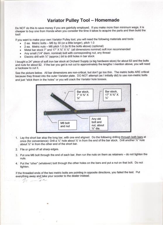

I'm ready to change my variator, but I'm stuck on the part of removing the drive nut. I see there's a special tool that goes into the holes on the drive face pulley to lock it, and some have posted shots of home-made tools. I have seen in other places the suggestion of locking the piston instead.
Questions:
1. If I want to make a home-made tool, what size bolts are needed? This tool doesn't look like it will be usable with the NCY drive face pulley that I ordered.
2. If I want to lock the piston, I have seen people shove rope through the spark plug hole. Does that seem even remotely safe?

I made a tool out of a piece of scrap plywood I had in the basement. It kind of looked like a slingshot but with a circle in the middle. The circle needs to be big enough to allow a socket through it. I then measured the distance between the two holes in the vario ( 80CM I think...) and drilled two small holes into the "arms" of the slingshot. Next, I found two 10-24 x 1 1/2" bolts and screwed them into the two small holes. Also, the "handle" of the slingshot needs to be about 8 to 10" long. After I inserted the two 10-24 x 1 1/2" screws into the two vario holes, I screwed one of the long transmission cover screws back into the middle tapped hole. The handle of the slingshot rested on that screw and I was able to grip the socket wrench with both hands to loosen that nut.
After I installed the new Vario, I covered the threads of the 10-24 screws with a couple of small pieces of tubing. Then I simply inserted then in between the fins of the new vario and did the above process in reverse...
I hope this helps...

Found this on the tinternet
- ImageUploadedByTapatalkHD1432834016.517183.jpg (87.57 KiB) Viewed 5978 times

Thanks maddiedog. I went ahead and bought some rolled steel and built my own tool. It was cake to take off the variator set. I bought the NCY set but I have only received the drive face and the rollers; the variator is apparently still on the sea, so I probably won't see it for a few weeks. In the mean time, I replaced only the rollers (new ones are 13g). The rpm's seem like REALLY high, but I'm used to full stock so maybe what I'm experiencing is normal. I assume I need to drive it for like 60-100 miles before the ECU "learns" the new dynamics? Will the new drive face + variator make much of a difference over just changing the weights? Should I go back to stock weights until I have the full set? I will say I went 0-40mph super fast (felt like 5 seconds maybe?), but I never really gunned it before on stock. Please tell me all of the things!
P.S.: I used 1/4" bolts instead of M6; they fit perfectly in the variator holes; there was no wiggle room like the M6's had, but it wasn't so tight that I had to thread it.
