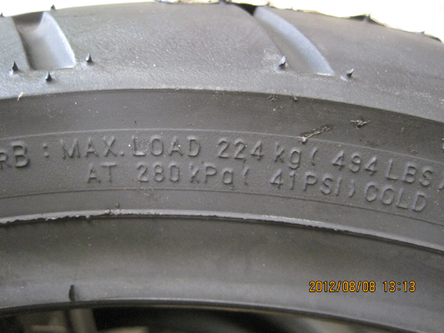

DrewJW wrote:My manual claims 33 psi on the rear solo, and 36 psi two up.
Hay Drew, that is what Honda feels would be the correct ratings for everyday normal.
However, there is also a spec on the side of each tire stating what the tire mfg feels is safe.
Each tire and mfg will have its own rating - so you have to actually look at the side of each tire to see that rating.
PSI & max wgt rating 900k.jpg (227.93 KiB) Viewed 8740 times
This is an example of that rating - this is not a PCX tire.

I believe this argument has stood for years, who is right. The people who design the bike, or the people who just design the tyre, and make it for a set wheel size.
aka DrewJW
Re: Riding 2013 Pcx over weight limit
DrewJW wrote:I believe this argument has stood for years, who is right. The people who design the bike, or the people who just design the tyre, and make it for a set wheel size.
I can feel my will to live ebbing away already. Something in the low 30s the for the front and high 30s for the rear is good for any modern bike
The rear tyre on a scooter may feel warmer to the touch (and that isn't necessarily a bad thing) because if has a more direct heat line to the engine than a motorcycle as the engine and rear drive are a unit. And heat sinks
