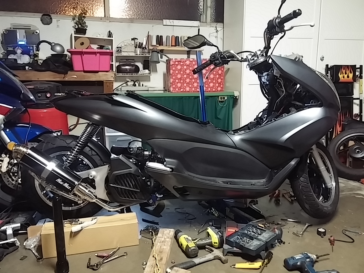

Part of the Fairings on
- 20141130_174833.jpg (536.16 KiB) Viewed 5857 times
Re: Stretched engine mount
Painted audi daytona grey matte
