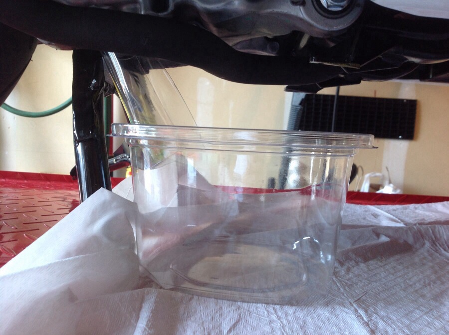

I felt that I just had to relate my latest oil change adventure to this 'clean' oil change thread. This happened two days ago. It gave me the push to create the OCD oil change kit for my next oil change. Keep in mind that I usually spill only a drop or two when I normally change the oil. However, a neighbor came over and wanted to keep me company in my basement workshop. He has more tools than Harbor Freight (which is his favorite store) but he doesn't spend much time using them, and after this oil change adve tire I can see why.
He asked if he could help me when I changed the oil on my bike, so I gave him the task of holding g the try after I positioned it. Well the first 1/2 quart went well, but then I noticed this creeping pond of black stuff moving out from u der the bike. I asked the friend to please push it up closer because the oil was missing the pan. Long story made short, the other 1/2 of quart that was in the bike never made it to the pan, no matter how hard the guy tried. I think he needs to get his eyes checked. I wear bifocals and could see that the pan was at least an inch too far forward. He kept moving it in the wrong direction! Well, after I had fished the drain plug out of the oil pan and cleaned it up, I reinstalled it and went on a hunt for something to soak up the oil. I found a bag of wood chips which worked better than nothing and at least contained the oil. My neighbor, meanwhile ran upstairs yelling that he needed some Winded. It seems he thinks Windex will clean up anything, including 1/2 quart of synthetic oil!
Moral of the story, don't let your friends and neighbors help you unless you are certain that they can HELP. His help turned into an additional 30 minutes of cleanup. In the end though, the oil did get changed. However, he also wanted to help me change the final drive oil, so it suddenly did not need to be changed. ;-)
