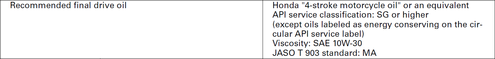

Any idea which kind and how much? Is it the same like mechanics use in the SH300i (0.28L, API SG or higher, 10W-30 & JASO MA)?

Mine says HP4M 4-stroke motor oil or equivalent.....
same spec as your pic shows.
on how much, it says pour oil in the filler hole until it comes out the check hole.

BRed, when you say "mine" you mean in the service manual of Honda Forza 300? The part of picture i've posted comes from SH300i service manual. Anyway, JASO: MA-2 for the engine (low friction) and JASO: MA (higher friction) for the final drive as i can tell...

GN2, the engine oil is has to be SAE 10W-30, API SG or higher & JASO T 903 MB. The final drive oil has to be SAE 10W-30, API SG or higher & JASO T 903 MA.
