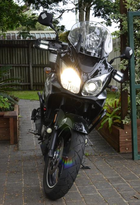

That picture illustrates what I am trying to say. He did a good job with the additional lights though, giving people the train like look :-)

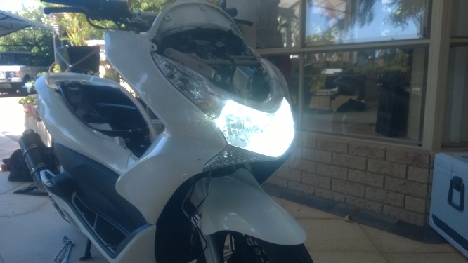

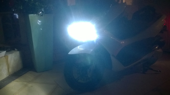

Which emitters and ballasts did you get? 25 Watt? 8,000k? The pattern is perfect but the light output seems to be a small amount and is way too blue.
geek77
Posts: 39
Joined: Mon Dec 01, 2014 1:23 pm
Year: 2012
Color: Grey metallic
Re: headlight upgrade
Post by geek77 »
It looks a bit weird on these photos but it's absolutely white in real life, with blueish cutoff. I will try to get a picture with more realistic colors.
35W 6000k.

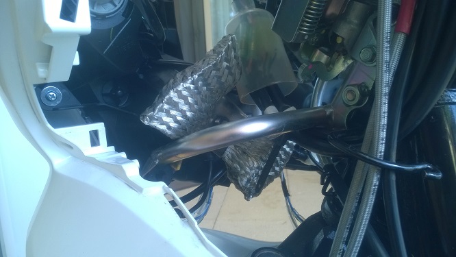

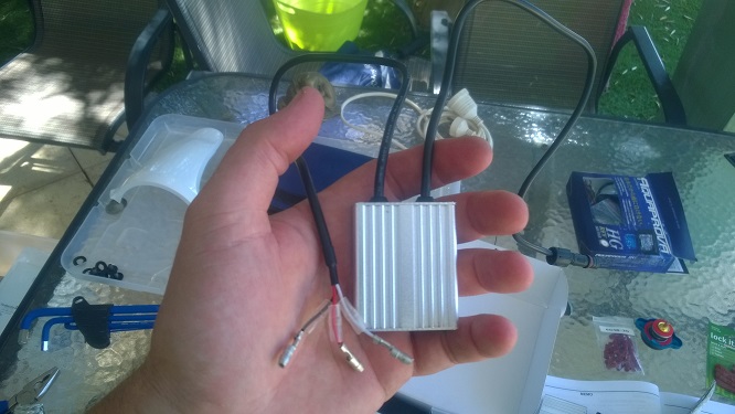

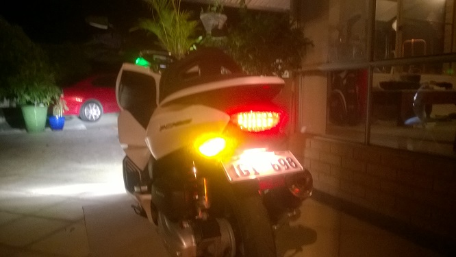

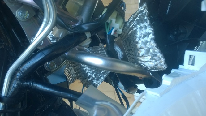

chainsaw
Posts: 117
Year: 2013 150esp
Color: white/carbon

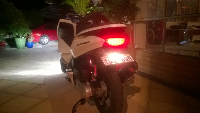

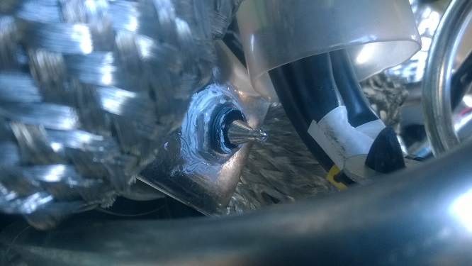

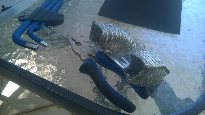

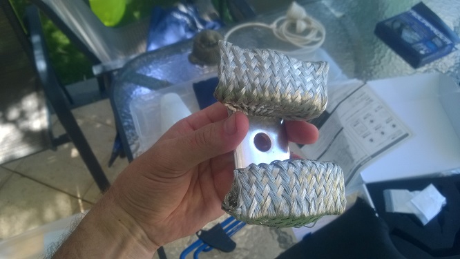

Post by chainsaw »
