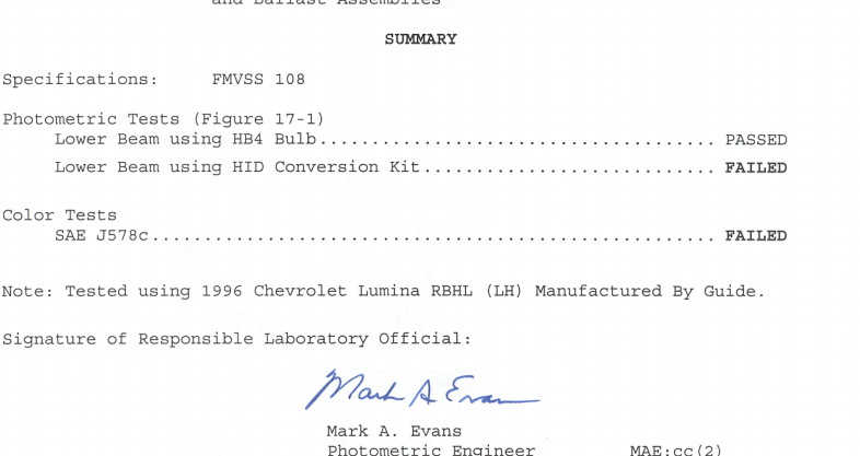

His argument against HID retrofits describes a totally different shape of the light source and then he shows a comparison with drawings and scaled measurement graphics which appear to me to be nearly identical on the applicable scale of things.
I agree, the early HID cob jobs were totally terrible with a one size fits all bulb that had the light source extended a 1/2 inch to far into the housing. They sucked and people like you still seem to think this is the current state of affairs. But the modern HID retrofits are designed to exactly replace the halogen bulb that you took out so the fire is in the exact right place. They work perfect and provide exactly as good a beam pattern as the halogen with twice the light. And the kits are offered with a choice of light color which if you are not a teenage kid that wants purple just because, you can choose 4,500k which is the perfect color to see and be seen. These are much safer to see and be seen with than the stock halogens. As soon as motorcycles come with night road illumination and daytime running lights that are on par with a modern car, I will stop advocating for upgraded headlights and additional auxiliary lights on bikes.
- sendler2112
- Posts: 1412
- Year: 2013 PCX150
Re: headlight upgrade
Interesting that his own tests show more light AND a better pattern with the HID conversions in the second two examples. Four times the light.
http://dastern.torque.net/techdocs/HID/ ... _Retro.pdf
http://dastern.torque.net/techdocs/HID/ ... etro_a.pdf

Fact is that the first of your official documents that tested retrofit HIDs said that with it installed, it failed all US standards! Please see the screenshot I attached.
My wife nearly hit a ditch in the countryside because some a*sehole blinded her! Once you are a passenger in a car and see the effects on the driver (who might not be as technically versed or know where to look at but just a housewife trying to get her kids from A to B), you will loose all sympathy with whoever uses blinding devices in traffic.
What you give us in your last post is a website from a vendor who wants to sell his products. Of course (as he wants to sell his products) he will not tell you the bad bits. Plus, the fact that he is allowed to sell the stuff does not mean that it is legal for use on the public road. Even in highly regulated countries like the UK or Germany you can buy stuff that is technically just for show or off road purposes (e.g. 100W halogen bulbs, HID kits, spray that blacks out lights, 90% window tint film...shall I go on?).
