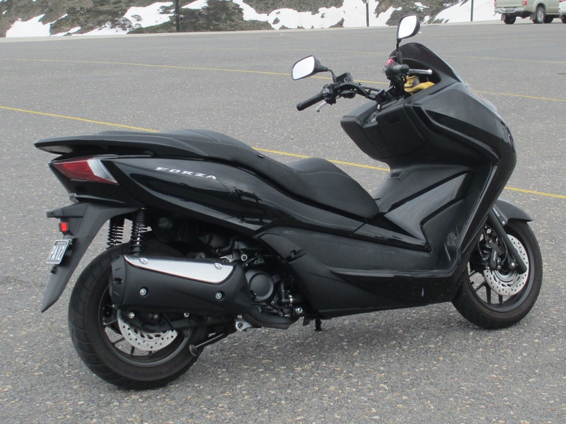

DioTiAma wrote:... 10.300 kilometres on my scooter.
Hi! Just from the small bit of your Forza that we can see in the picture it looks interesting. Is it possible to show some more details.
There are NO accessories available for the Forza in Australia. Everything has to be privately imported from Europe or Asia.
I have had my bike's seat re-upholstered and now it's much better for touring (see attached). More pictures from this forum are at http://hondapcx.org/viewtopic.php?f=22& ... =20#p48620.
