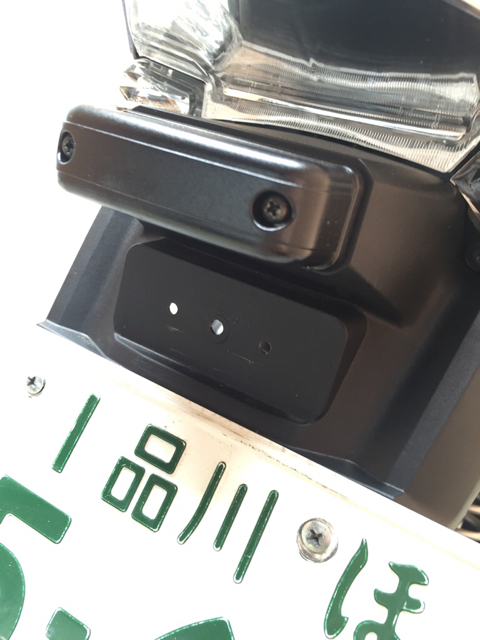

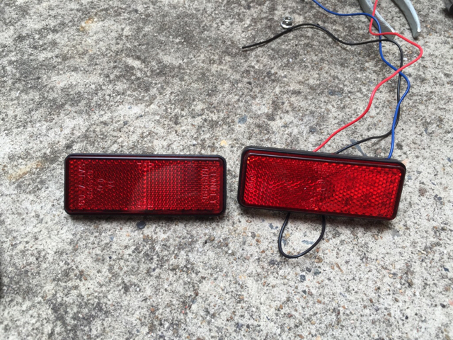

Just thought I'd share this with you. I was looking around to replace my rear red reflector off the rear mudflap and found this that should be an exact replacement (after measuring the original reflector and it's the same size with the same centre nut and bolt fitting) of the pretty useless reflector.
http://www.ebay.com.au/itm/2pc-LED-Refl ... 2a480de9ca
It's a very cheap mod, looks stealth, should have 2 brightness settings and give another brake light at the back.
Anyway, I've got some ordered and share how it looks on the bike when I get them.

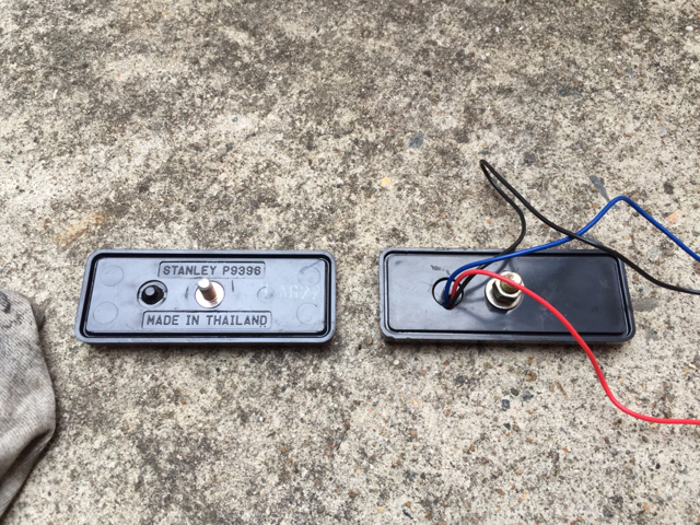

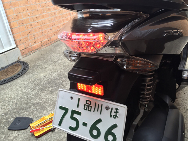

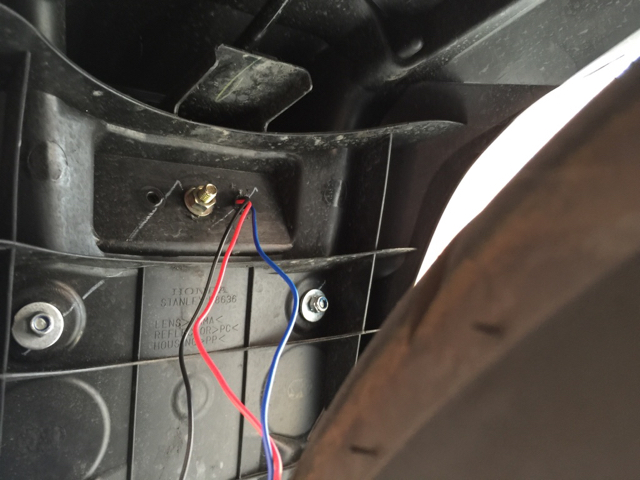

Here you go guys. It's not that hard. You just need to take off the top cover for the passenger grip and you should have enough space to splice the wires together. As I've got LED tail light replacement, the wiring colours may differ. But here's the photos which I hope is self explanatory
Wiring were red is brake + and black is -ve. No surprises

Sorry about the wrong order of the photo

3 lines came out of the LED tail lights (it's a replacement tail light, not a bulb replacement). Red, yellow black. Yellow is parking lights. So for the wiring, red went with red, black went with black and if you want the constant parking lights, yellow on the bike with the blue in this LED reflector (I chose to leave this disconnected).

I somewhat agree that these aren't worth installing because of the lack of lumens. Possibly they'd only be good as parking lights and nothing else but for a few dollars including postage, I don't know if I could have expected anything more.
