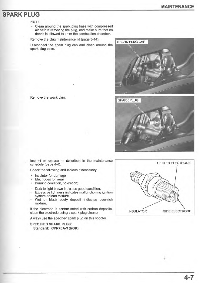

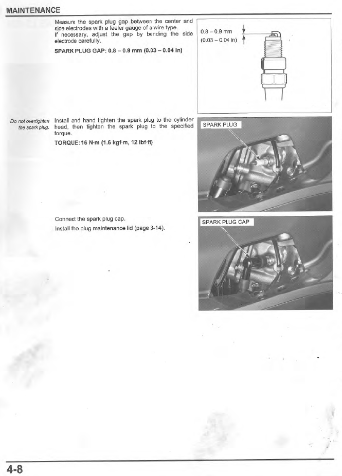

I checked through my old packet of papers from when I bought the PCX. There was no instruction manual. I found a downloadable manual from ClubPCX. The task looks pretty easy. Thanks for the tip.
Re: need instruction for how to replace a spark plug
Ew, the Vietnamese one?
First off, make sure not to overtighten the spark plug. The spec for it is 16 N/m or 1.6 kgf*m or 12 ft/lb, which isn't much past hand-tightened.
If you buy the manual, you need pages 4-7 and 4-8. I took pics of the pages you need from the English manual:
Enjoy! ;)

anyway, the main concerns with changing the sparkplug are.
1. dont let any small rocks, dirt or other crap get into the spark plug hole as that can damage the cyclinder wall. (probably not a concern on the PCX with the way the spark plug goes in)
2. be very careful not to crossthread it
3. dont overtighten as maddie already said.
it is easy to damage the threads of the soft engine metal by cross threading or overtightening.
