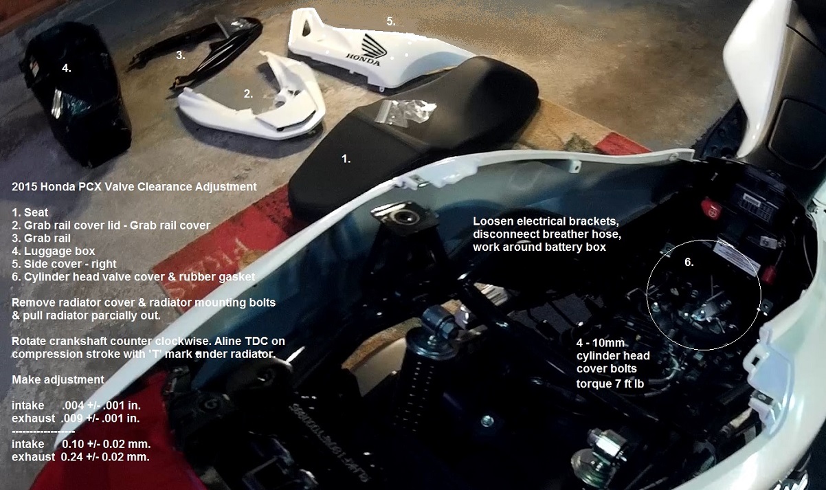

I was thinking the same thing at one point in the valve clearance check process. It occurred to me that it might have been possible to pull the seat and luggage box only. This would have left me to work around just the battery box to get the intake valve clearance. Then perhaps up from the bottom of the PCX through the skid plate panel for the exhaust. If you have to take the battery box out you must remove both 'body panels' which sets all of it in motion. So yes... next time I'm due on the 2015 PCX I'm going to try and work around battery box removal first before submitttting to the SM's long 14 procedure process because I actually did the luggage box out of sequence in my video just by chance so I know it will come out before the two 'body panels'

Here's another thought on 2015's, if you are looking for a cheat don't bolt your battery box in after the first valve procedure and then just slip it out after luggage box removal
It would go like this and take about 20 minutes;
Seat - Grab rail cover - Grab rail - luggage box - battery - battery box
and you are there for both intake and exhaust... WOW!
Honda should modify the battery box immediately to be removable from a couple bolts or screws positioned just under the battery and be easily accessible through the interior of the box. This would cause them to revise the SM and save incredible man hours for valve clearance adjustment. Absolutely we are done here
somebody get them on the phone. I don't think they realized the redesigned PCX is this close to easy access.

That's very good info that the battery box is the main sticking point. It seems like an easy improvement to just not bolt it back in. I would think gravity would hold it in place adequately.

Yep this is crazy... thanks for starting this thread DM. Maybe someone at Honda engineering will take notice. This image is all the proof they need to see anyone can work around those body panels to do what I just did the hard way.
5 simple steps... I feel even more abused now
all they have to do is modify a couple battery box fasteners for easy access up front and not down low under the body panels and we can all do our own clearance checks in less than an hour... DOH! Wait its becoming a little clearer
never mind, its all good, nothing to see here, move along...
I LOVE HONDA SCOOTERS

No I'm sorry it's a 2015 and I think if there was a short cut for valve clearance check on 2013 you guys would have found it by now. I think this is an oversight by Honda that will be making news soon enough as I have spammed it out for the world to see. DeaninMilwaukee and I had a beer and reviewed the video and DOH there is a simple solution to thousands of man hours tearing down the 2015's for clearance checks.Drifter wrote:Homie, is that a 13 you are working on? What has to come off now to get to the valves, i have no problem with leaving a couple screws or tabs or clips or.... off to make this crazy BS of parts removal easier!!
- Valve Clearance.jpg (273.84 KiB) Viewed 3839 times
