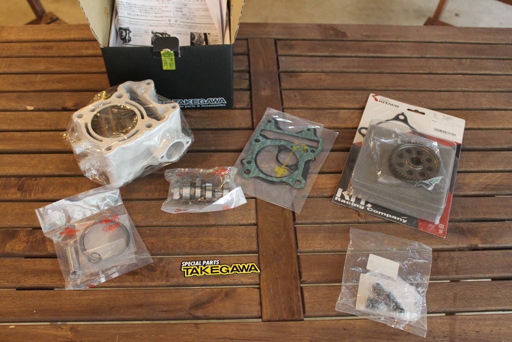

I have the kit in, and the bike hauls ass! I put about a mile on it, and unintentionally did a wheelie pulling out of the driveway.![]()

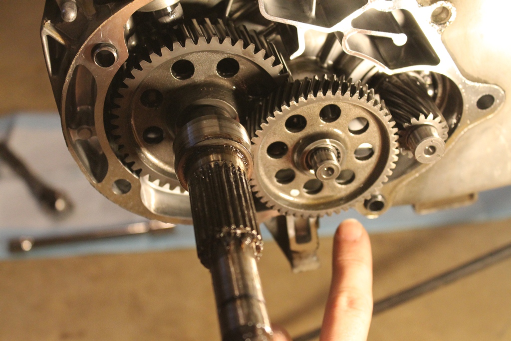

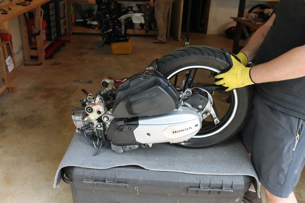

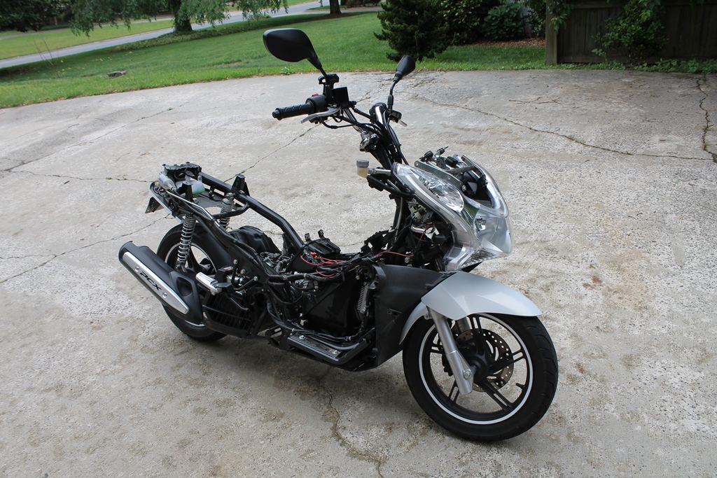

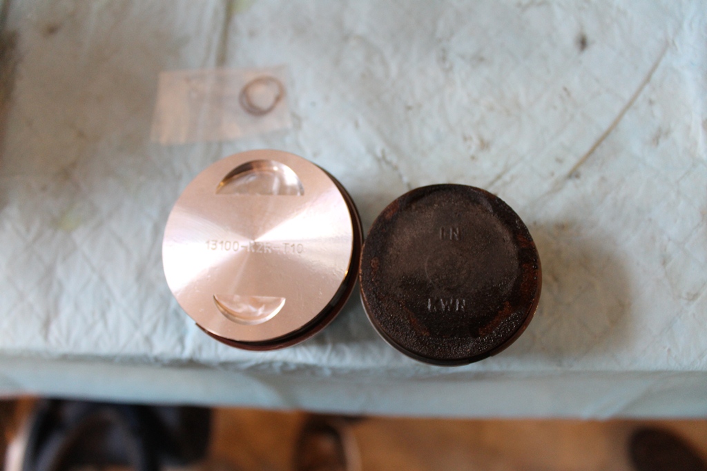

Some notes:
- I took pics of the ENTIRE process, and will write a comprehensive how-to very soon (two howtos, first how to completely dismantle a PCX, including steps for each panel, and a 2nd for how to install a big bore kit). The instructions with the kit are not straightforward and in Japanese, so a lot of the process was trial and error. Regardless, the process is fairly straightforward, and only has a few difficult parts. I feel confident anyone with a garage and some patience can do it, and even will include an exact list of the tools you'll need to do the job.
- The camshaft was slightly difficult to get out, but IMPOSSIBLE to transfer the idle lobe over to the new cam. The old cam was put back in. You NEED a bearing press for that part, and I don't have one.
- The injector was trivial to install, and was installed along with the kit.
- I did not pull my valves and lap them. I don't have time for that, or a clamp to remove the valve springs with. It goes without saying that I did not replace the springs either. I will see huge improvements from the kit alone, based on my experience so far.
- I did check the valve clearances, and they're in spec after over 6000 miles without checking.
- The gear up kit and that howto is next -- I did not get around to it yet, I ran short on time. I started, but the clutch is way overtightened from the factory, and even my impact drill could not remove it.

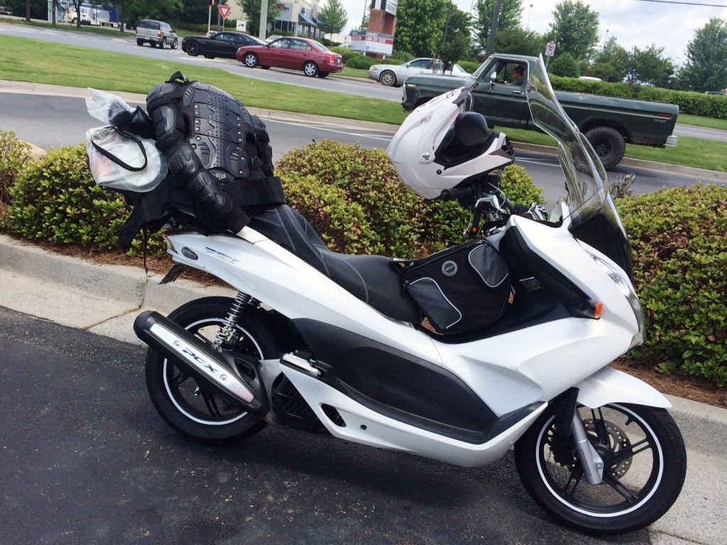

Some quick pics from this weekend:
Bike loaded up. I have my armor draped over the back, and got an adventure-style helmet recently. You can just see the LED foglights on the front forks, they are each twice as bright as the headlights and INVALUABLE on mountain roads at night. We're stopped at Bojangles "fried chicken" (in quotes because I'm not sure if it qualifies as food) for lunch. Maddie patiently awaiting a piece of chicken. I didn't want her to get the poops, so I gave her the biscuit that came with the meal instead. She LOVES biscuits anyways. Stopped at a gas station because IT STARTED TO FRIGGIN HAIL ON US. Little bits of hail the size of marbles fell for about 10 minutes, then it was clear. We had freaky weather the whole trip, it was about 25 degrees (F) colder than it usually is this time of year. The dude in the shot is my friend Freeman. Stopped at the campsite, dude in pic is Freeman again. I don't think there's any photographic proof I rode actually... And the hammock tent set up at the site. We didn't even end up using the tents -- it got down to 39F / just over 0C that night. Since my gear is good down to 50 degrees at worse, we ended up crashing on the floor of the lodge in the background of the previous picture. At least it was less cold that way.
