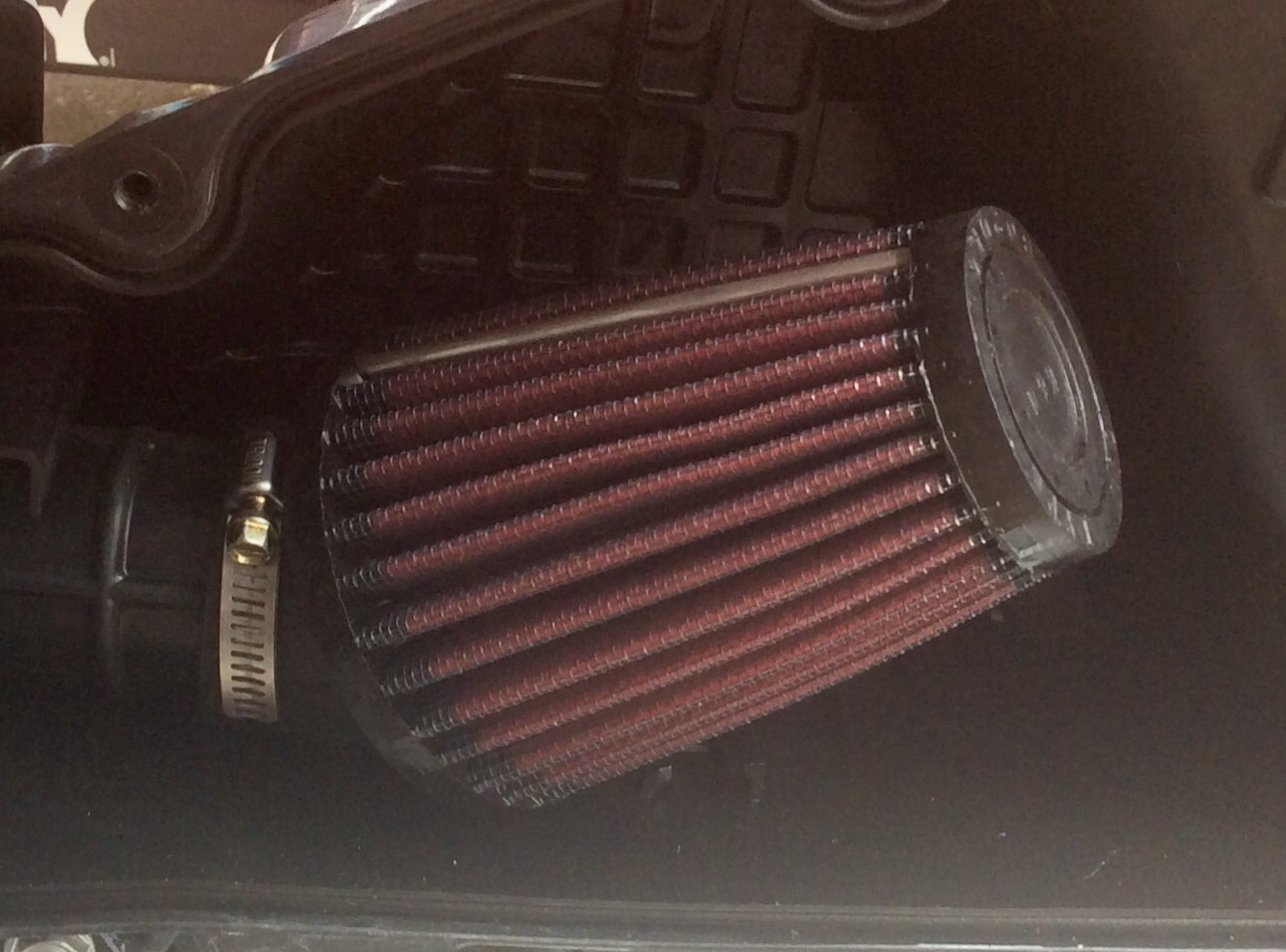

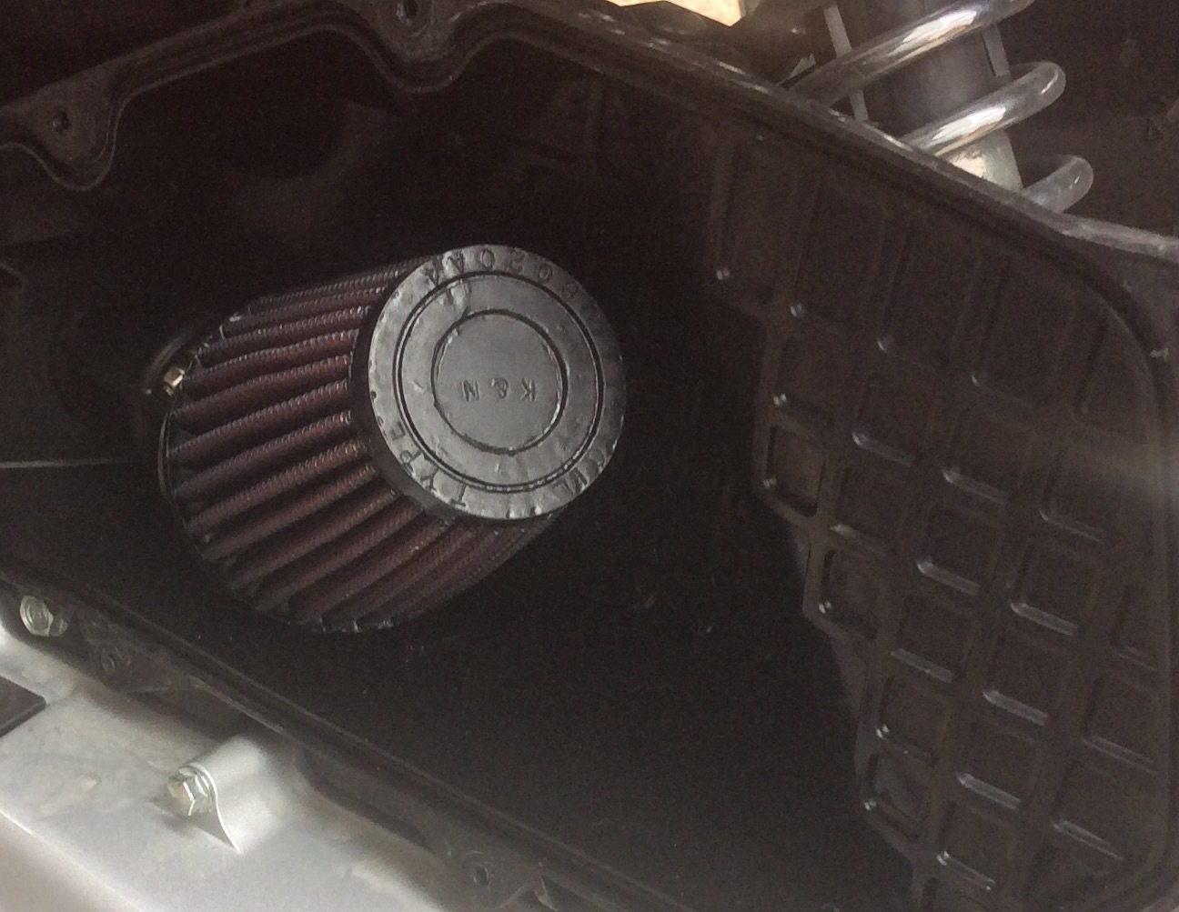

Here's pics of the Pod filter. It's still in question as to whether or not in boosted the performance of the scoot, but it sounds really sweet with the silent oval exhaust.
And here Youtubes with sound with the air cleaner cover on and off. The Snorkel is removed too.

I wonder if that pod filter has more, or less area than the stock filter?
vamootsman
Posts: 276
Joined: Sat May 10, 2014 10:42 pm
Location: Bettendorf, Iowa
Re: 2013 Performance
Post by vamootsman »
The stock filter has about a 15" surface area. The Pod filter has around 25
vamootsman wrote:The stock filter has about a 15" surface area. The Pod filter has around 25
It wouln't make the slightest difference
vamootsman
Posts: 276
I don't care if does or not. It sounds so much better, and is still far from loud.
