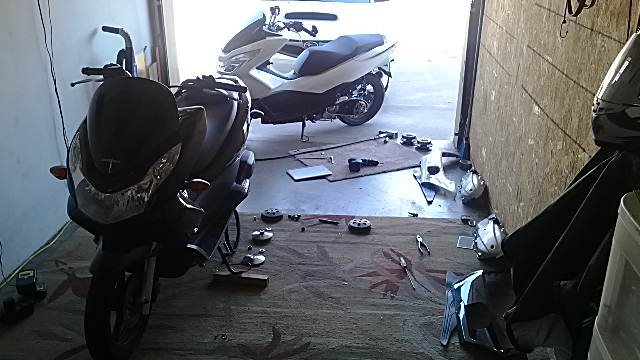

Decided to do some more tweaking on my scooters today. Swapped the 13G NCY rollers I had onto the 2015 that has the NCY varie and drive face. Ran it on the stand...79mph. Also through the NCY clutch Bell on there since it's been a long time and rolled down the street on it. Takes off a bit harder, but not worth the sacrafice in to speed or accelerated belt wear or other potential issues.
Swapped the OEM 2015 rollers onto the 2013 (from 18g to 16g).
Took the 2015 out for an identical 12 mile loop that I did last week and got 113.9mpg. Today, same trip yielded 120.5mpg with 13g vs. 16g rollers last time. Also, the scooter definitely pulls harder after that short lag on takeoff (which strangely enough one of my 2013's doesn't have while the other one did!). Though maybe the prev owner could have modded the clutch bell so tried swapping those but nope, didn't help. So, must be something internal, or just lucky? I dunno!

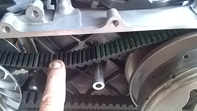

Also, the drive belt on the 2015 is grooved! Very strange. But I'm guessing it's done to decrease resistance as it travels the tight radius especially when traveling low on the pulleys. Maybe that's where part of the additional 8mpg manufacturer claimed mpg comes from on the 2015 compared to the 2013?
Ok, gotta go. BTW, I run the lightweight bell from the NCY unit on the back with the stock secondary slider. The 1.5oz prob doesn't hardly do anything really.

- ScooterMan
- Posts: 392
- Joined: Sun Dec 01, 2013 12:51 am
- Location: San Diego, CA
Re: 2015 pcx150 performance thread
THe scene of the crime!
