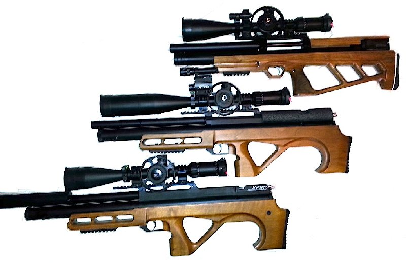

My wife said I really nurse these tiny projects. I am in the high-end ($2k b4 scope) airgun hobby too and we modify and tune them making for fun projects. These airguns can shoot under an inch at 100 yards (not my grandpa's Red Ryder lol). Anyway, I got the pulley holder but should see the belt in the next few days. Rain is forecast for the next 3-4 days. For gusty days at interstate speeds 150+ lbs or so is ok but it dinks it on the slow end. I never buy just one of anything except an airplane I have since sold that was a black hole for $$$. :lol:

SECoda wrote: airguns
I modified my Crosman Challenger to shoot 12 fpe with a regulator.

:) Sorry for off-topic.
