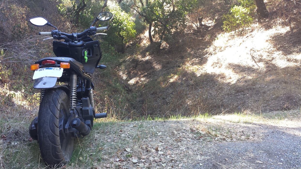

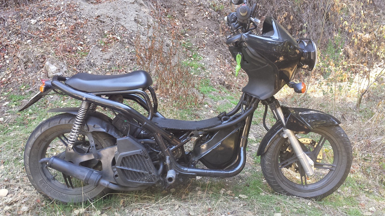

Re: Dasshreddar's PCX/Ruckus Hybrid
more
pics
- 14r4.jpg (567.72 KiB) Viewed 6478 times
- 14r3.jpg (570.55 KiB) Viewed 6478 times
Definitely diggin the scoot! Great work amigo! Although, where's your bar-end mirror? Those 2 side mirrors are too heavy!
Lost more plastic?
and more like a bike
I see you posting off road
doing any scrambling?
Now that you have the bike so gutted, might be easy to spend the $35 or so for a new 2015 fuel tank and see if it fits! Although, not sure how the sensor would work at that point.
I actually bet this thing flys with such a huge weight loss!
ScooterMan wrote:Definitely diggin the scoot! Great work amigo! Although, where's your bar-end mirror? Those 2 side mirrors are too heavy!
Thanks, I actually like the stock mirrors... might get some of the 15 mirrors because my right mirror has some pitting in the glass.
I offroad wherever I can, its fun.relic wrote:Lost more plastic? and more like a bike I see you posting off road doing any scrambling?
I could make the new fuel tank fit, but not sure if I would have to get a new fuel pump too? I'll let someone else be the guinea pig for that.ScooterMan wrote:Now that you have the bike so gutted, might be easy to spend the $35 or so for a new 2015 fuel tank and see if it fits! Although, not sure how the sensor would work at that point.
big ruckus is too FAT, little ruckus is to low, and pcx ruckus is just right.WORFAB wrote:so call me crazy but why didn't you just get a big ruckus lol it keeps looking more and more like one
Surprisingly I can reach my top downhill speed faster than before... I think getting rid of the "splash shield" behind the front fender helped more than expected (acts like a air-brake).danieljw wrote:I actually bet this thing flys with such a huge weight loss!
