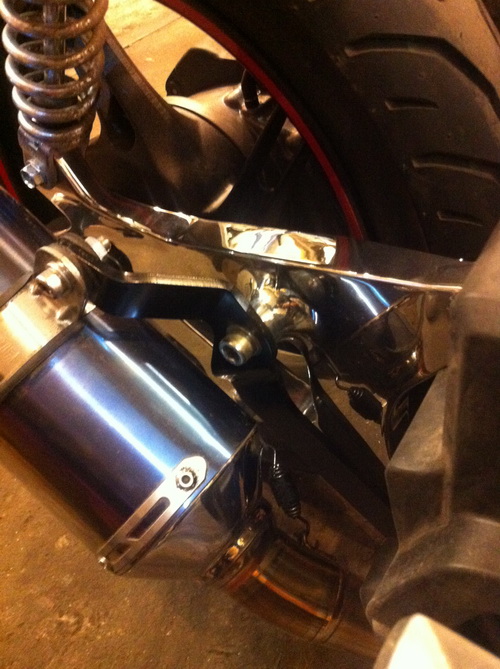

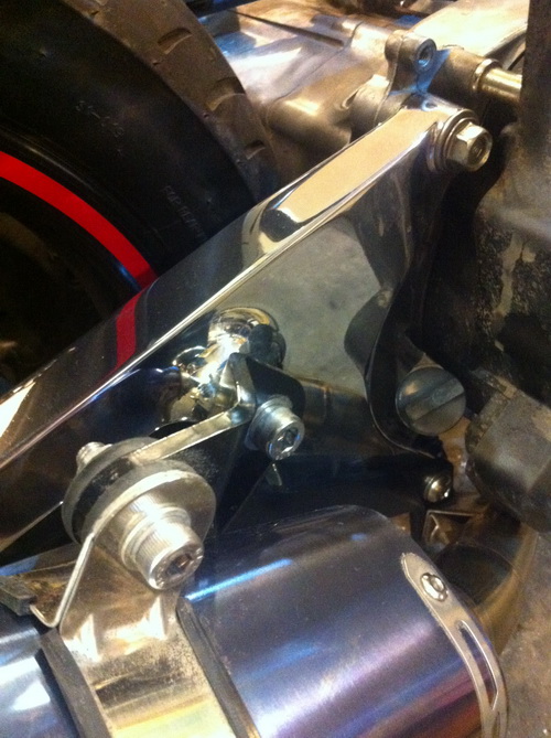

Hello, pcx people!
just finished polishing the swingarm! Looks awesome in my opinion!
Still didn't try the new engine, it is hard snow ouside and I still can not find the proper 50mm intake pipe to complete the intake assemlby.
Will try to do a search in a truck/bus shops.. it seems that cars don't use that much big diameter pipes..
My vario is Yuminashi speed combo, I will check how it work and will try to use the Daytona vario to compare, it is not expensive just for test, will add it to a basket to my next webike purchase.

Re: Pcx Yuminashi Chainsaw 164!
That looks good buddy,how did you get it done like that?Reaper wrote:Hello, pcx people!

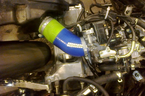

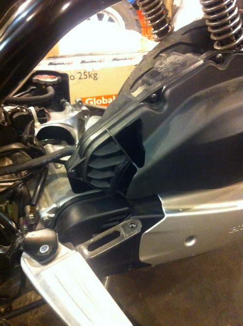

For the 50mm intake hose,just go and scour engine coolant hoses from the local car parts shop. You should be easily able to match it for size and the correct bends to fit in to the airbox. They will deff be longer but just cut length to fit (make sure you take with you the current connecting intake hose to match the bends for the new one..)

My car use 60 mm and in the moment is running a pod filter so I think you should not have problems with it.

Hi all!
Finished with the pipe with this.
Looks shitty, 2-piece construction with some internal imperfections, but with a perfect shape. I have to add one more wide bracket in the middle for sure.
Just tired searching for this 50mm pipe around, may be later I will see it somewhere and cut

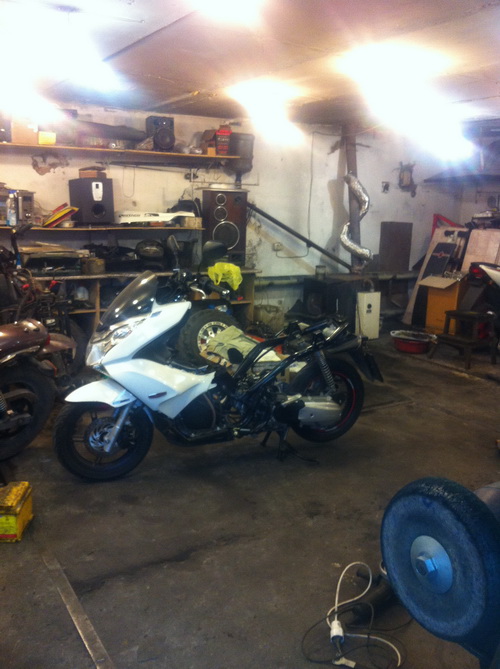

Heh, today I am planning to take the scooter back home, have to ride thru clouds of dirt, snow, ice, water,etc.. The temp outside is around zero.
To polish the swingarm you have to use the sandpapers with different grits, then polishing with pastes like dialux. Motocross people do polish the bike's frames, so they know how.
I did a engine head porting to fit Yuminashi intake manifold, and polished all the inner surfaces to a mirror too
So here was a tons of work with the bike, and I am highly excited to try it out!
