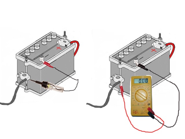

Re: Battery drain
That's only going to tell you if it's charging. To check drain you need a 10amp or above ammeter or multimeter. The meter wires have to be put in series with the negative terminal of the battery so what your doing is wiring it between the negative battery terminal and the earth wire. If there is a drain on the battery it will show on the meter. This is not something you should do if uncertain of what your doing as wired wrongly or drawing too much current through the meter ,eg by operating the starter for example will damage the meter.
If it's under warranty then leave it to your dealer is probably the best advice.
