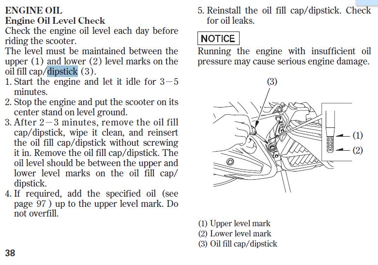

Hi, I have uploaded a picture of the relevant page in the owners manual
- Page 38 of the owners manual
- PCX150 oil level from manual.JPG (100.74 KiB) Viewed 11907 times
Re: Oil Dipstick marking
That's over the max if you have followed the instructions. Get a syringe and take some out
The essential part of the instructions is that you need reinsert the cap-dipstick WITHOUT screwing it in. Thus, yours looks over full, but if you screwed it in, then it may not be over full. Do it again without screwing it in.

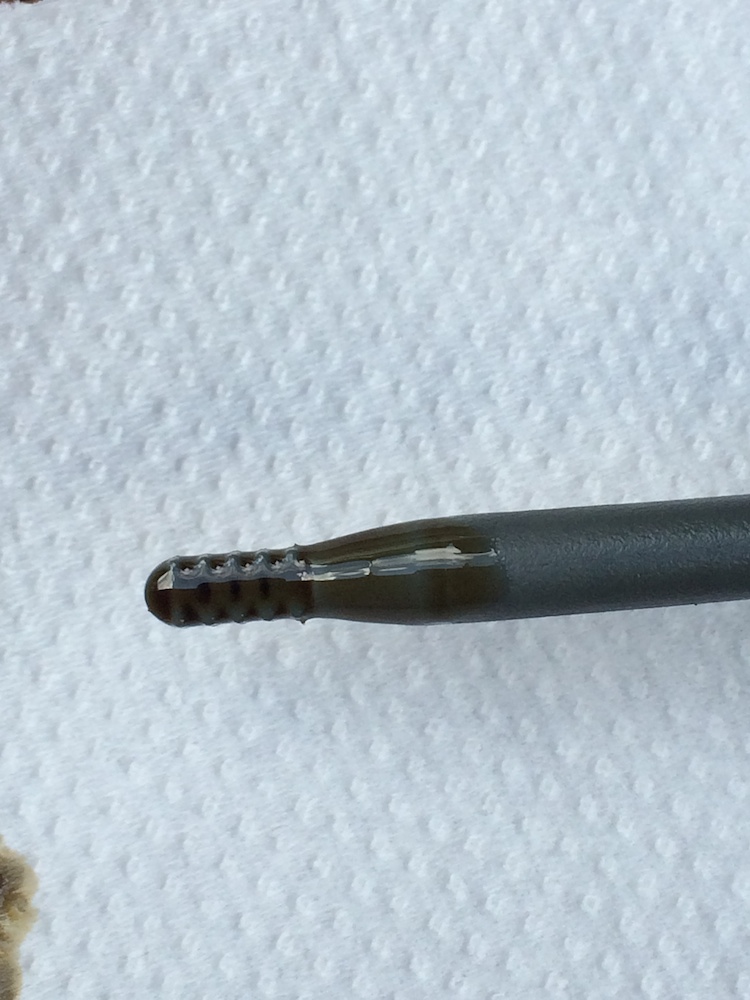

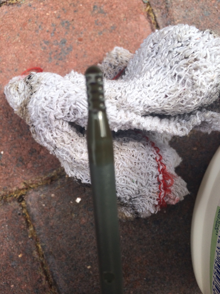

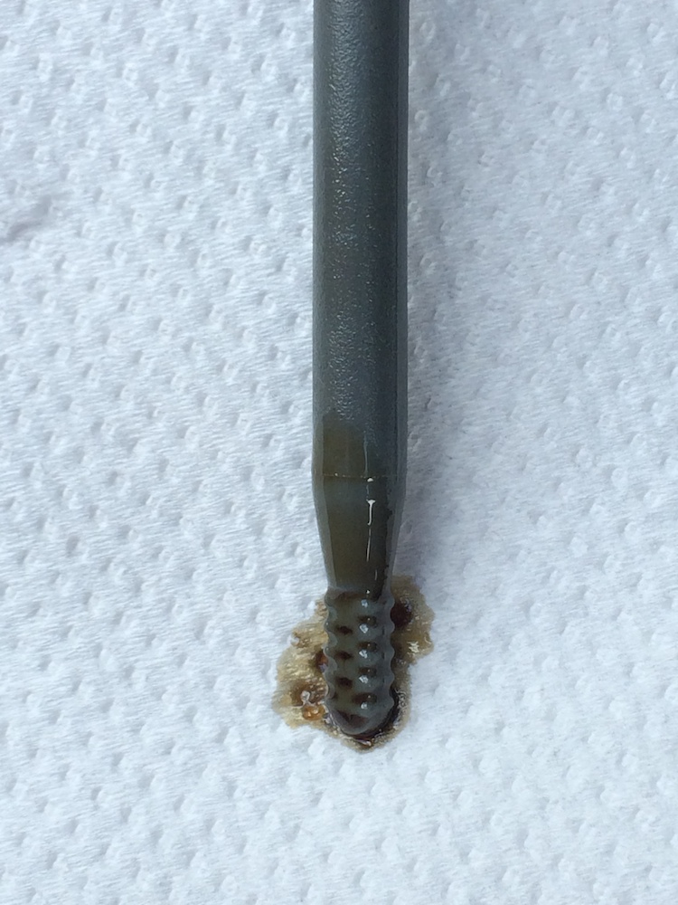

I screwed it in, I haven't touched the Oil at all since getting the Bike,
and I doubt they would of done anything with it on the first Service?
so i'm guessing it's the same oil etc from when the Bike was bought new
(June 2013)
Will do it now without screwing......
here are 2 photos I took,
took it out, wiped, put it back in without screwing, then back out,
seemed high so did it again, and cleaned any other Oil from around the Bike etc:
But again, I haven't touched the Oil,
and it's only had 1 Service done,
which was done late at around 1500 miles,
nothing else.
Oh, this was with the Bike cold as well,
went out earlier but it's cooled now,
shall I let it run for a bit and then do it?

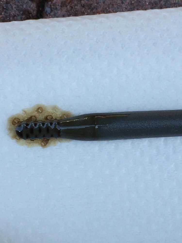

Just ran it for a bit, then left it for 2 minutes,
took it out, wiped, back in, out... and still seems too much
(photo)
but again, i'm pretty sure this hasn't been touched since purchasing the Bike,
as a first service wouldn't need a oil change etc...
it's done just over 4000 miles now,
1500 of them done in the past 2 months,
Air Filter changed and Spark Plug, but still something doesn't seem right,
isn't as smooth riding as when I got it,
seems like it's struggling a bit...
also when riding, and picking up speed, when it gets to a certain speed the Bike sounds weird and then settles,
not sure if this is normal or not.
