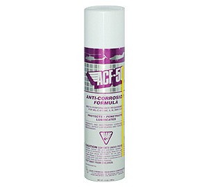

Not really. It stays inside at night but sits all day outside at work in all weathers. I use ACF50 on it so it's stayed pretty corrosion free.
It gets cleaned on a regular basis as well so it keeps the grot down.

How often do you apply and to what areas? Thanks for the help

I use it on the alloy parts as it stops them going that powdery corrosion way. It seems to last ages so three or four times a year but mostly when the weather gets bad. It keeps the salt down. You can put it pretty much all over, but obviously not the brakes,wheels,tyres etc. I put the bike away for the worse of the winter so it gets a good coating then.
Keeping it clean makes a big difference. It also give you a chance to spot anything that might give you problems sooner rather that later also.
