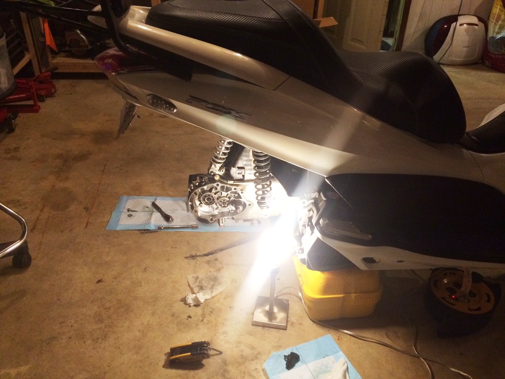

maddiedog wrote:I went ahead and spent the $130 to buy the kit. I'll update back here how it goes, and will likely make an actual how-to for it; I didn't make a how-to for the Kitaco gear up kit. :)
I started installing this last night. It took less than two weeks to get in, that's fairly fast for overseas shipping.
The gearbox area:
photo 1.JPG (227.04 KiB) Viewed 5530 times
I need to find a hydraulic press to push the old final gear off the driveshaft and push the new one on. The old final drive gear is a fair bit larger in diameter than the new one, and the old stock gear that turns the final gear is way smaller in diameter than the new one.
Re: Gears for higher top speed
For reference, that final gear is ON THERE. The 12 ton press couldn't handle it, I had to use a huge one at a machine shop at work. The Yumi kit's installation is not for the faint of heart.
